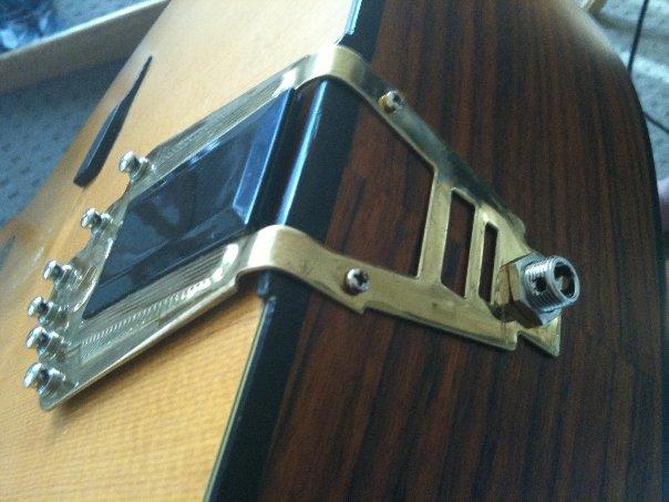

    Posts: 1,691

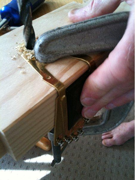

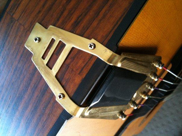

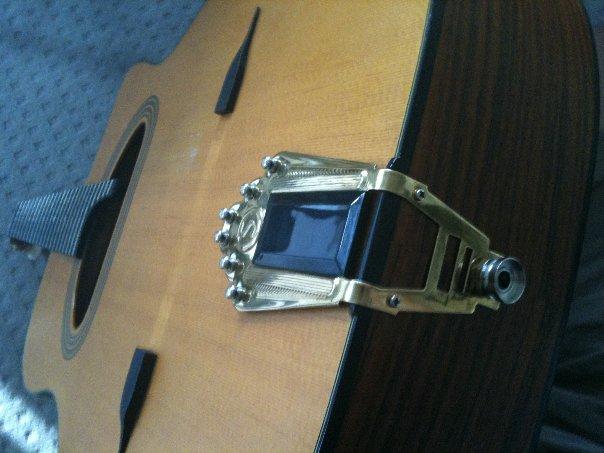

    I did that to install a K&K once. Drilling the endpin hole to 1/2 inch. Directly through the tail piece and the tail block.
    No issues, no surprises, it all worked fine. And it was good to have the jack in the tail-block, because it was sturdy (allowed even use the jack doubled as strap pin).

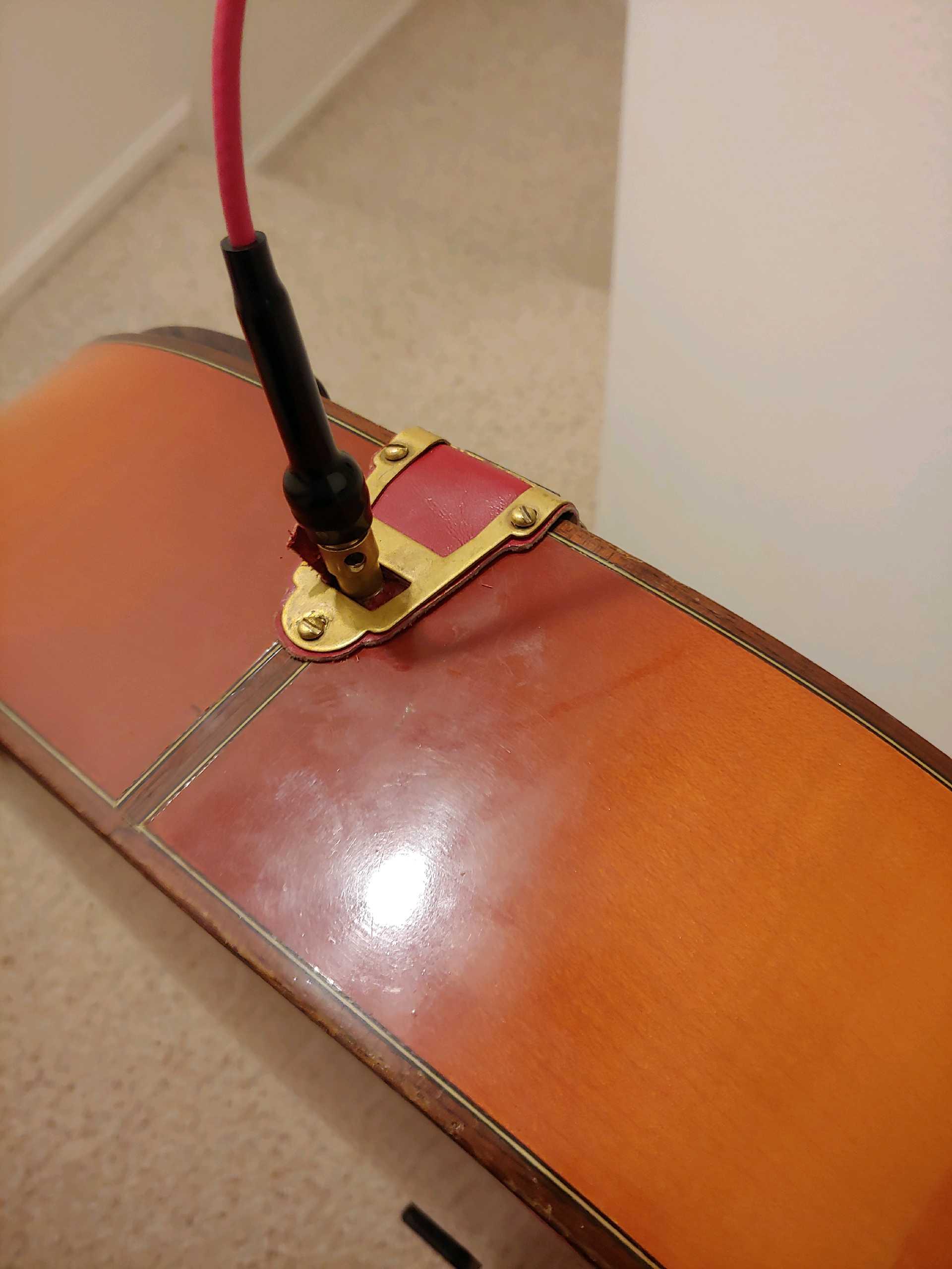

  • edited April 2019 Posts: 6,156
    @flaco Yeah 1/8" mini female jack, flush panel mount, is another thing I was thinking about doing.
    I had that on the K&K pickup I had back in the day, though this was the outside mount with the jack resting on the tailpiece. Then I made a cable that had 1/8 on one side and 1/4 on the other.
    But if I do that this time, then I'd just make a short adapter; 1/8" male to 1/4" female so I can use standard cables I already have.
    I haven't heard of Tapastring. Those endpin jacks are awesome for flattop guitars.
    @Wim Glenn just the thought of that size, 1/2" makes me cringe (I know, says the guy who went to town with that soundport). Maybe... I already have a good quality jack that's meant to double as strap pin.
    If I went that route I'd probably do as I mentioned above, 1/8" flush mounted jack, and use a short adapter cable.

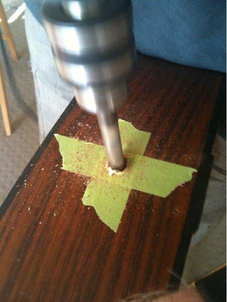

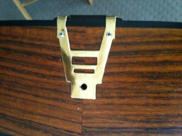

    edited April 2019 Posts: 1,691
    found more pics.
    drill the tailpiece separately from the lower bout.
    use masking tape to prevent the sides (which are usually laminate) from splitting up.
    don't worry about 1/2".. there is a much bigger hole in the top. :)
    BucoLango-Django
  • Posts: 6,156
    Haha you're right about the bigger hole on the top. Yup that's the same type jack I have. I haven't seen yet what Jokko includes for the inside mount kit.
