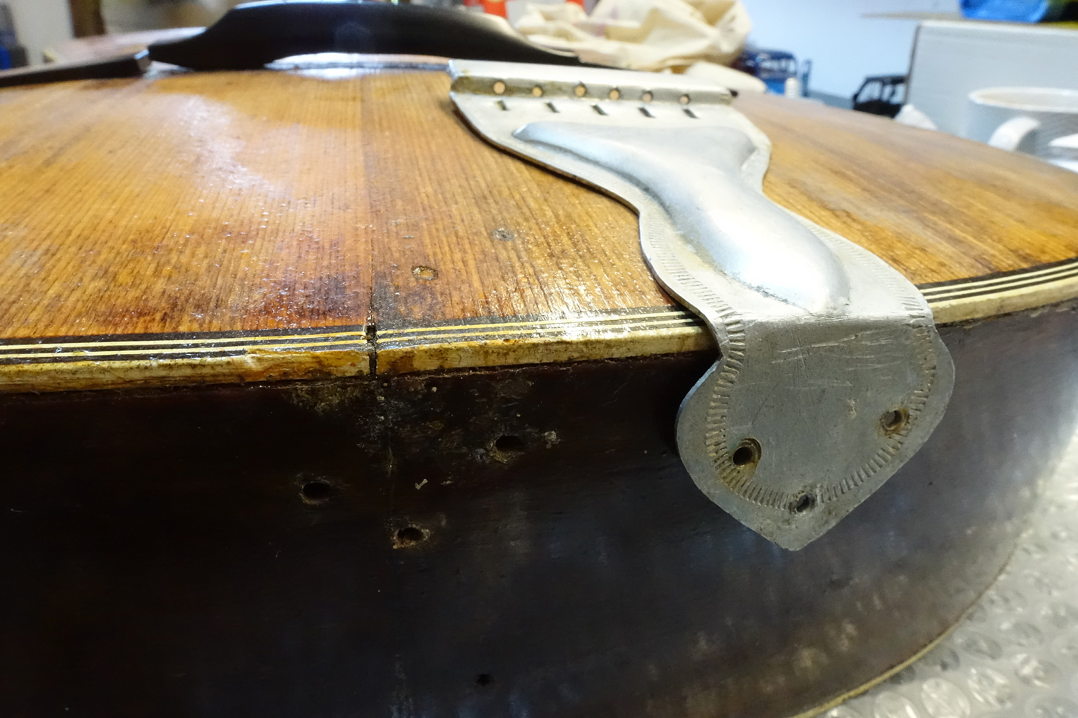

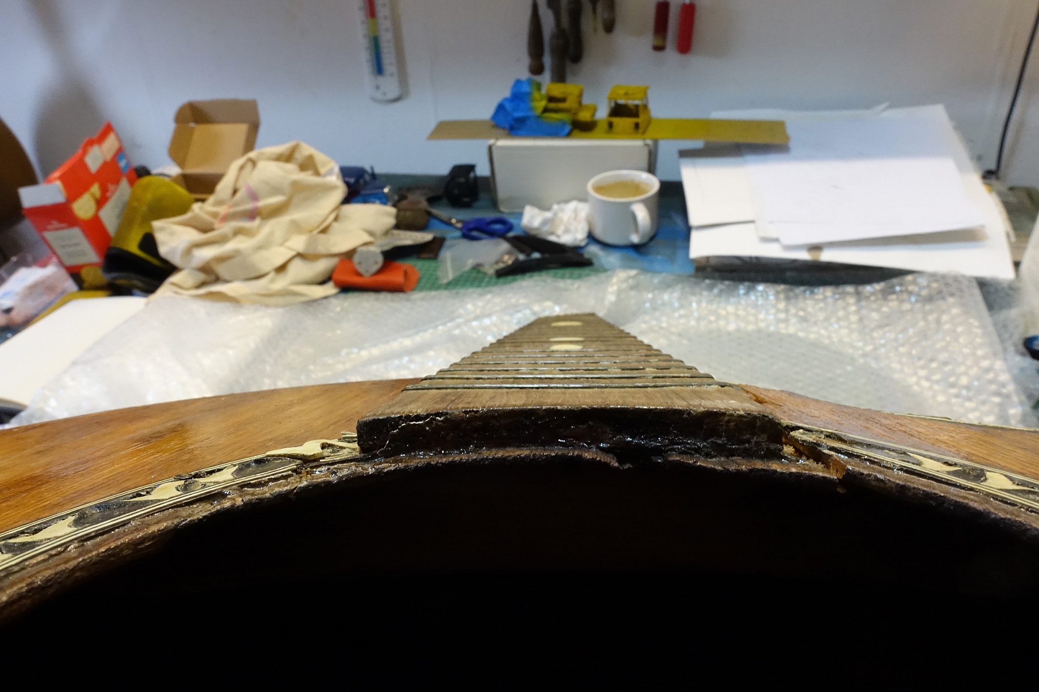

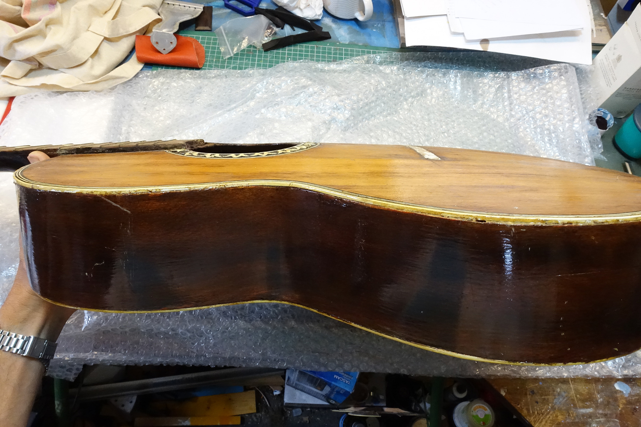

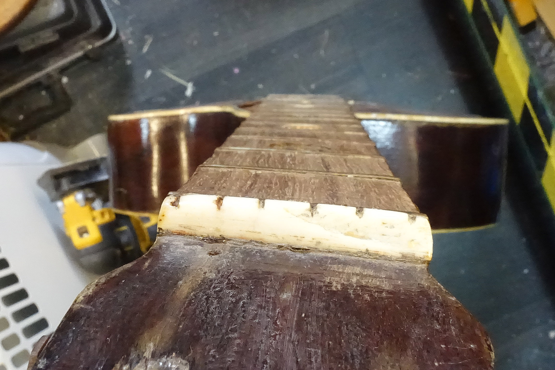

Here is the guitar. Everything fixable, but I need to think carefully about the neck. There is a slight twist. It would be ok as it is I think, but I'd much prefer to have a nice straight fingerboard - I want this to be a playable guitar! As it is, the bridge sits directly over a brace (thoughts on that please). The scale is long at 680. There is no radius to the fingerboard. I could plane the fingerboard flat and add a slight radius. Could I make it a 13 fret join, and reposition the bridge slightly forward? There is plenty of space to do that on the fingerboard.
The tailpiece looks original - no other holes underneath. Machine heads need switching round!! but they work.
Any other thoughts? It has a huge bombe to the top!
The second picture explains that tailpiece. Before I was scratching my head thinking why it has only five holes in it. Thought you're supposed to pull the strings through them.
