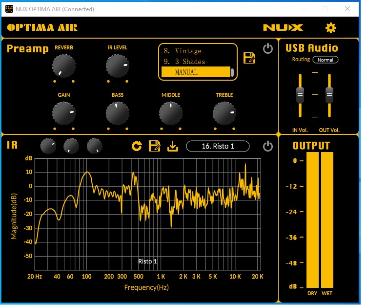

    Take a look. I mean they're not night and day but still different. Top one is mic aimed at the neck, strings strummed like chord.

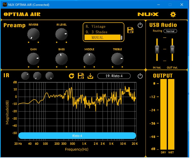

    This is mic pointing at the tailpiece, strings picked one by one. Less peaks and valleys and especially bass has much more even response.
