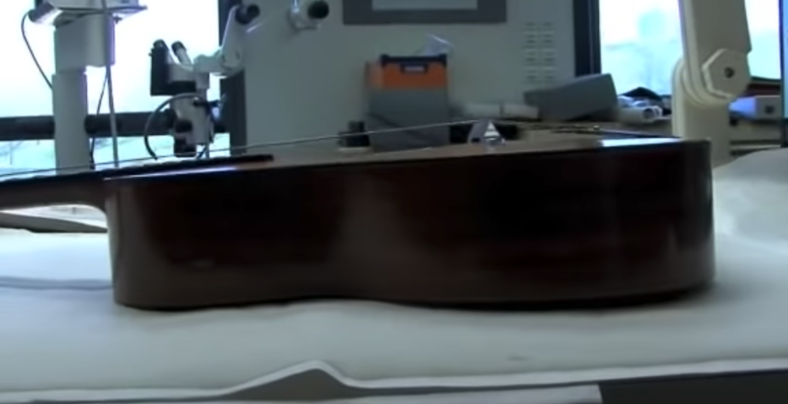

    Found a picture of Djangos Selmer 503....That is easy 1/4"
    if I ever seen one. Granted who knows how it was when he played in back in the day.
