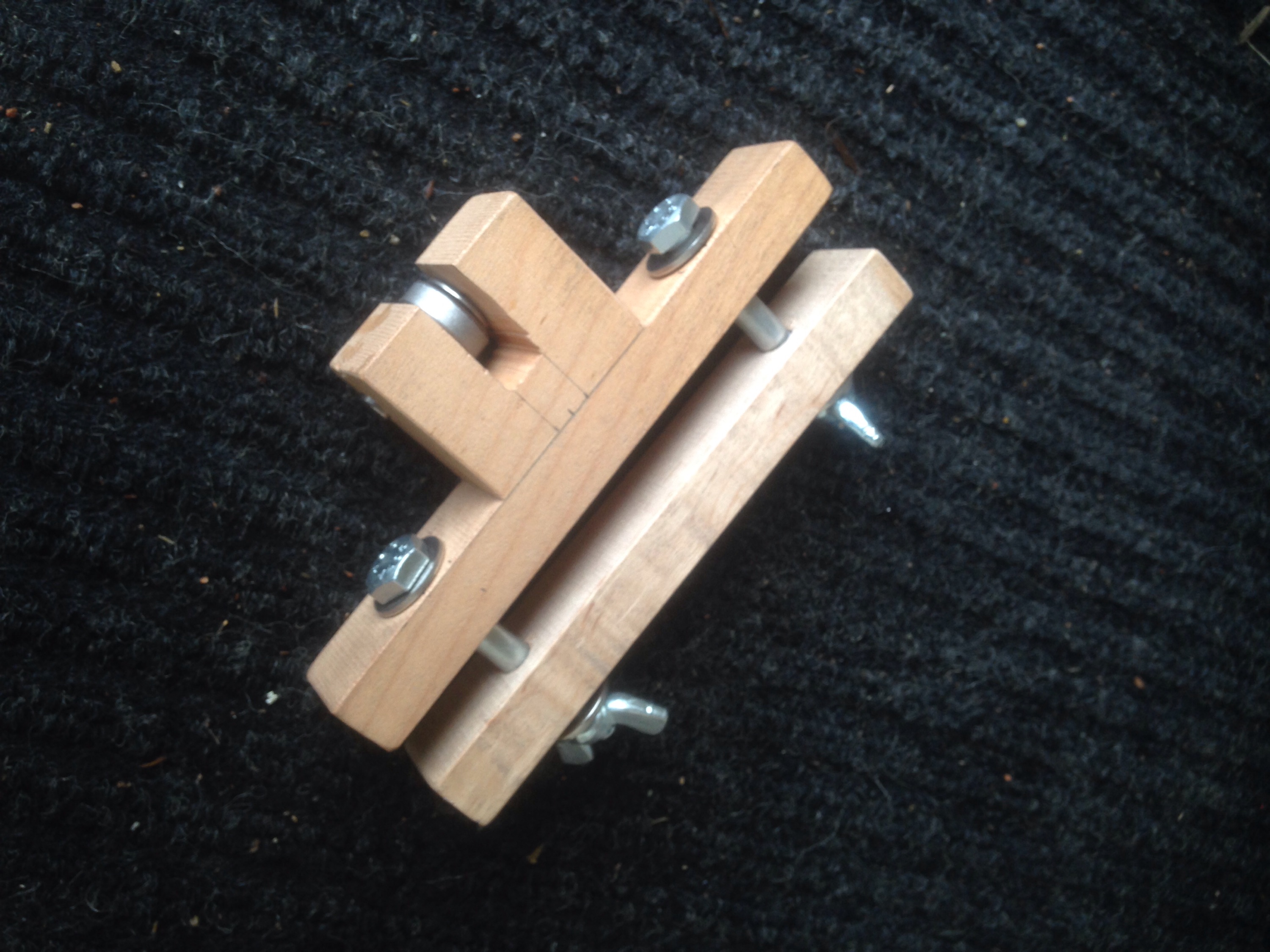

    I sand mine with a straight motion back and forth in the direction of the neck (not sideways and not twisting). And I don't move very far from the final bridge position since the top shape changes slightly. I just use small movements. I also have a fixture that holds the bridge upright so I don't tilt the bridge back and forth. The idea is you want the bridge feet to match the shape of the top as close as you can get it.
    BucoAndrewUlle
  • Posts: 6,164
    That was my problem @Bones I'd end up rocking the bridge as I was sanding straight back and forth and ended up with slightly convex shape on the bottom. Can you describe the jig you came up with?
  • BonesBones Moderator
    edited December 2021 Posts: 3,339
    Like most of my jigs, it is made out of scrap wood (I used maple but any hardwood will do). The purchased parts are a ball bearing, a pin for an axle for the bearing, 2 screws, washers and wing nuts. There is also a washer on either side of the bearing so that the outer race of the bearing (which is acting like a wheel rolling on the guitar top) doesn't rub on the wooden body of the tool (I hope that makes sense). The bridge just clamps into the tool with the wing nuts. I tape the piece of sandpaper to the guitar top with that blue low tack tape and I also put a piece of tape over the sandpaper where the ball bearing rolls just to not scratch up the bearing too much but that is really not necessary. Also, when you pull the tape I usually use just a little heat from a hair drier (don't over do it) to soften the adhesive and pull the tape perpendicular to the wood grain. Again this is probably not necessary since it is low tack tape but I do it just to be sure especially if it is a new instrument without finish as it is easy to lift out the soft spruce fibers. Let me know if you have any questions.
