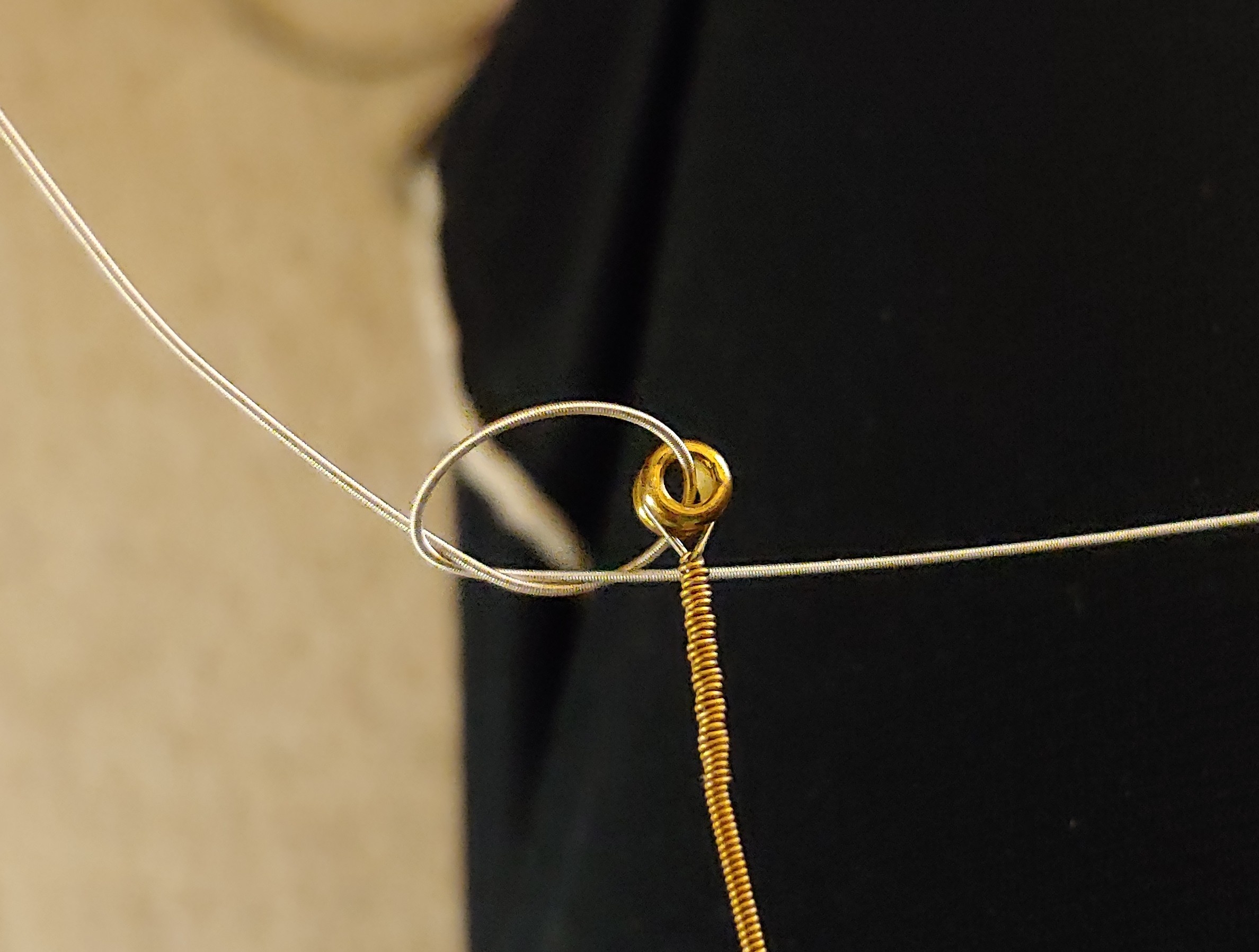

    Paul, I don't remember if it happened with LaBella specifically but yes that's happened to me with sometimes smaller loop. I'd usually get a ball end from an old string as I always have a few around and thread a string through the loop and tie a basic knot at the end, put extra few twists if unwound string.

    Buco, a bit unclear what your method is. Do you mean you take the ball from an old string, insert it in the (small) loop of your looped string, and fasten the ball in the loop? If so, can't picture how you're doing - sorry, man.
    That sounds right. On the picture imagine the ball end isn't attached to the string, imagine I'm just using the ball end to attach the string. With wound strings this single knot is all it takes usually.

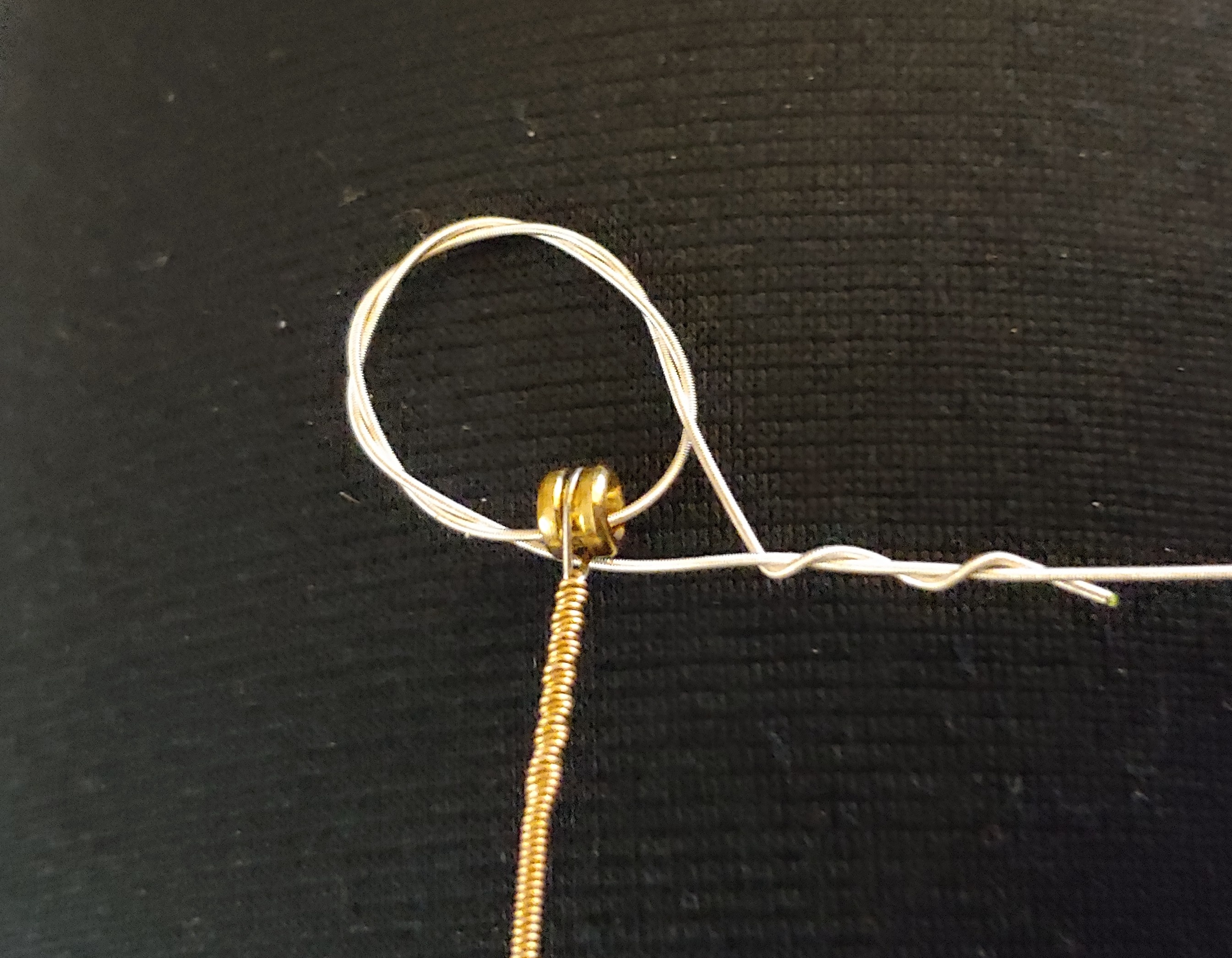

    If it's slipping and especially on unwound strings I'd do this. Again imagine I'm just using the ball end. So I'd do a few more passes with a working end and maybe if it's still slipping twist the end. Of course I'd tighten the knot.

    Wow, thanks for the explanation and photography, Buco!
