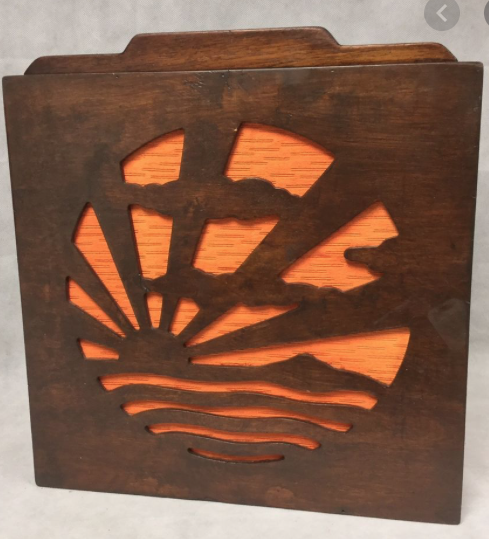

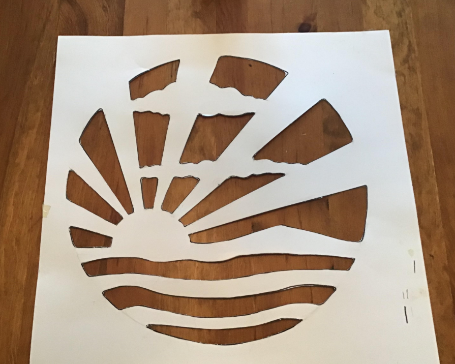

    Tomas, I am a fellow lover of the vintage look and I, too, like to create things.
    About ten years ago, I had a similar idea to yours... I was too lazy to construct a whole new amp and cabinet like you are, but I wanted to give my amp a vintage Art Deco look.
    So I made a three-sided wooden box to put my small Mini-Loudbox amp in, which also served as both a music stand and a carrying cart for my amp, guitar and banjo.
    Unfortunately, the whole creation finally proved to be way too heavy to be practical for taking to gigs, but I still have the template I made for the front grille of the cabinet, based upon the old UK Pye "rising sun" style radio grilles of the 1930's.
    My creation looked really nice with beautiful wood veneer on the front. And for speaker cloth, I found a brown tweed fabric as similar as possible to the ones the old radios had. The diameter of the circle above is about 46 cm.
    If my template would be of any interest to you, I would be happy to fold it up and put it in a big envelope and mail it to you in the Czech Republic... please PM me if interested.
    Regards,
    Will
    PS Here is the design I copied mine from... interestingly, in my research I learned that this beautiful "rising sun" design was immediately discontinued by the Pye radio company in 1939, when the UK went to war against Japan...
