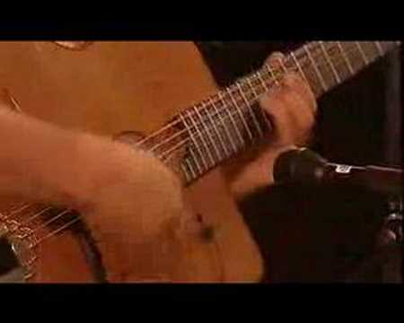

    Try as I did, I was unable to capture a clear close-up of the headstock logo on this video.
    What I *did* capture were a few "interesting" screen-grabs from the "Live at Samois" video. The more I watch it, the more convinced I am that this DVD is the GJ equivalent of the "Zapruder film;" almost every frame is worthy of analysis!
    I offer these shots without comment. You folks will chime in, no doubt. :wink:

    Thanks man!
    That first shot captures a great view of his right hand.
    Also looking at the bridge it seems he plays with rather low action, the pic could be misleading but it looks that way to me.
    Posts: 6,287
    The height of the bridge itself doesn't tell you much. So much depends on neck angle and how arched the top is. I have two guitars here made by the same luthier, one has the tallest bridge I can find and still has only around 2mm action. The other has the lowest bridge I can find and has over 3mm action! Why? Because the first one has more neck angle then the second one.
    Just judging from the sound of Stochelo on that DVD, I'd say it's not that low. He's playing pretty hard and he gets very little buzz. It couldn't be too low...
    I played his Eimers guitar a few time when I lived in Holland. It had pretty standard Gypsy action on it....probably in the 3-3.5 mm range. I had to hit it pretty hard to get any buzz. But he may have it lower these days....I don't know.
