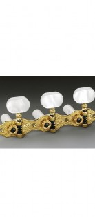

Anyway, here’s what her knobs used to look like…
Now I have already gone to Father Castellucia’s website and have been informed that they are Schaller HGO1.
So, that’s my sad tale, my brilliant friends, I hope if you have read this far perhaps it has amused you enough to help me with a few questions…
  • Can I get away with just replacing the one busted knob? Because the metal hardware seems pretty much intact.
  • If so, what kind/size of Schaller peg would match Lucia’s?
  • Or would anyone perhaps advise replacing the whole HGO1 unit instead?

    If the shaft is bent you’ll almost certainly have to replace the entire set of tuners. A broken button can be replaced, but I’ve never seen just a shaft replaced.
    Posts: 1,896
    Thanks, Michael. Luckily for me, the shaft still looks pretty straight…or at least within range of being straightened with pliers… fingers crossed…

    My local luthier was able to glue the three pieces of the broken tuner button back together again and I watched in amazement as he sprayed some mysterious substance on it which made the glue dry instantly… who knew such a thing was even possible?
    Then I watched as he reinstalled it.
    And now it works perfectly. You can’t even tell it was broken.
    His price for doing this? Zero.
    Wow.
    He’s been similarly generous in the past so I’m gonna go to the bank and take out fifty bucks to give him.
    But I think I’m going to take his advice and buy an extra button from Schaller for future reference, just in case…

    The mysterious substance may well have been water - it activates superglue. Great job!

    Some (cyano)acrylate adhesives recommend an accelerator. I never understood why to put that on first. I couldn't see it, like it had evaporated...so I said to a co-worker, is it just a cleaner? 'No'.
    It seems to work when applied afterward. "You're doing it wrong".
    Moisture (H2O) does activate or cure some adhesives like Gorilla & either acrylic or urethane circuit board conformal coating (or both... don't remember).
    But the accelerator for some Henkel/Loctite glues is not water.
    https://mysds.henkel.com/SAP_GATEWAY/odata/SAP/YPSSWH_DOO_SRV//DocContentSet(Appid='YPSSW_SDSUA',Matnr='000000000000471307',Matnrcomp='',Subid='000000153667',Subidcomp='',Sbgvid='MSDS_UT_AU',Laiso='EN')/DocContentData/$value
    After reading all the extremely flammable solvents in it, I still think it...well, can't argue with chemists. There are glues that don't stick to certain plastics due to some surface property. Maybe it optimizes the surface in some way other than cleaning.
