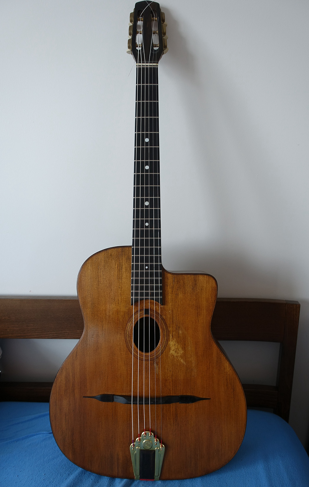

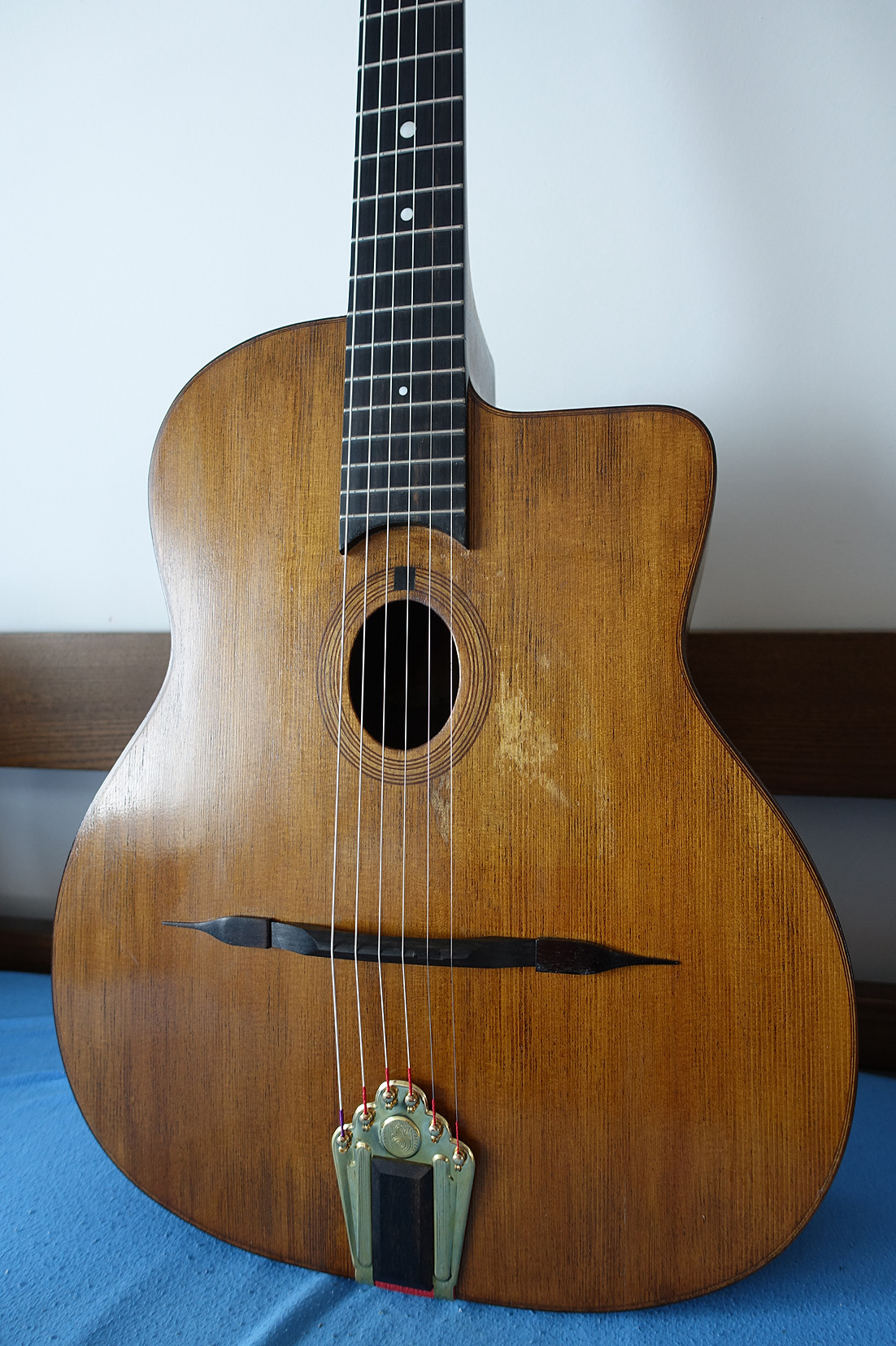

I played it for a couple of weeks but wasn't very happy with the sound - a bit dead! so I took the very thick lacquer off the top, back to bare wood. I finished it with shellac and settled back to enjoy a better - but still not brilliant - sounding guitar.

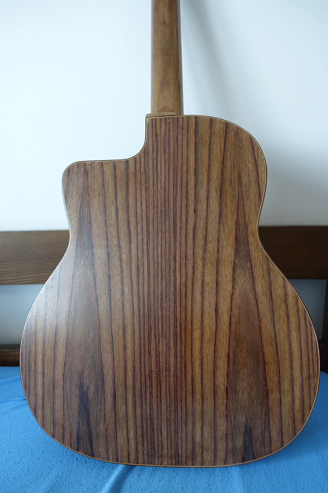

Fast forward to this year and I've been selling a few guitars (and buying a few). The Gallato was earmarked for selling, but I was still curious to know what would happen if I took all the finish off the back and sides. I've just completed that, re-profiled the neck to take off the squareness, done a bit of aging and finished lightly with shellac. The result is so much better! There is an open, brighter and sweeter woodiness to the tone now, that just wasn't there before. It feels nicer to play as well with that more comfortable neck shape.
In summary, I will hang onto it for a bit longer! If I do come to sell it, someone will be getting a very nice sounding and playing instrument. If only Serge Gallato could sell his guitars with a light lacquer or shellac - underneath, they're excellent guitars and very nicely made.

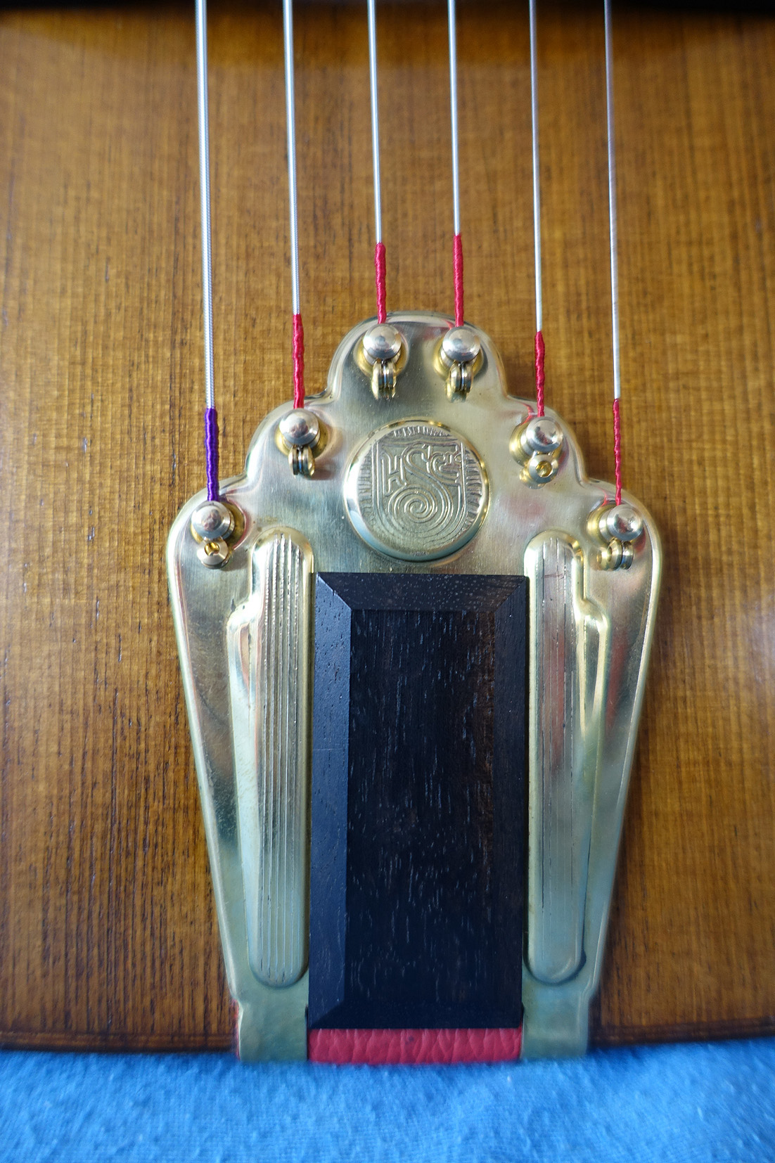

Oh yes, and I finished it off with a Killy Nonis HSC tailpiece.

    Wow, looks stunning! Almost like vintage.

    A very handsome looking instrument! I note you have a .45 purple E string, but the rest seems to be the .11 set. Is that your normal setup or was this just what you had on hand? Curiosity killed the cat, as they say.

    The purple low E was because it was missing from a set of 11s for some reason, and I just needed to get strings on! It seems fine to me (maybe a happy accident!).
    As far as the vintage look goes, when I pulled off my home made pick guard from 2015, it pulled some of my old stain/finish off - but I thought it looked good so left it.
