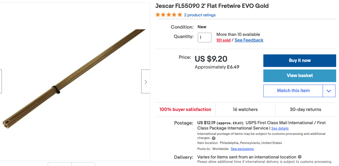

I'm looking at Jescar EVO gold 55090.. (good choice??)

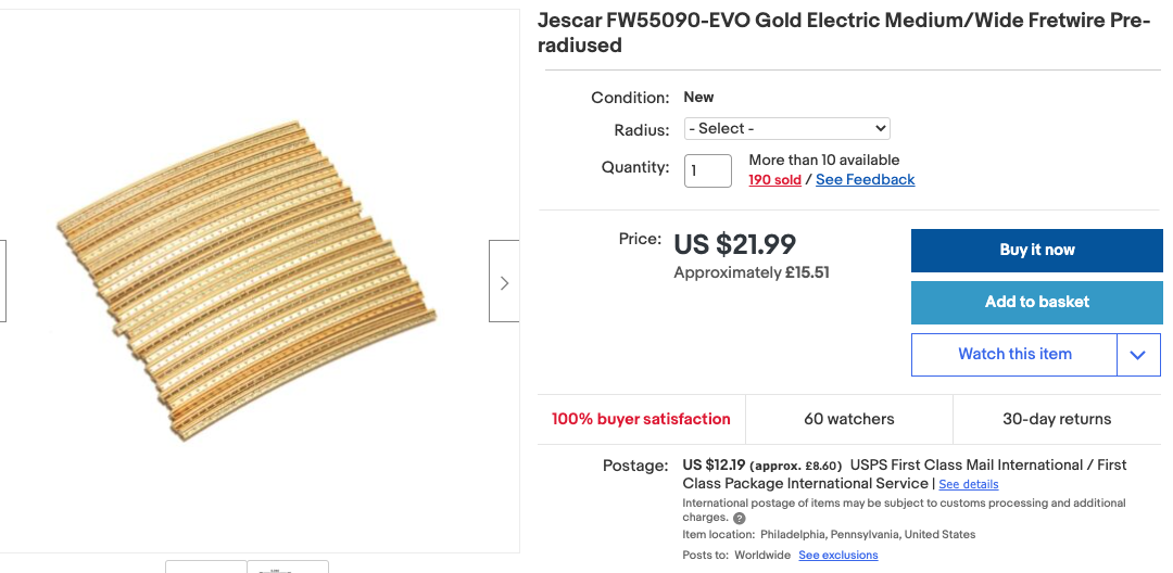

do I buy it flat? (since the fingerboard radius seems so slight..)
or do I buy it 'pre-radiused' - (and what if I can't find it at my required radius?)
Also - please pipe up if you think I am making a rookie error going with this wire!! :D - haven't ordered any yet.

    I've never used that I just get mine from Stew Mac. You need it to be radiused just slightly more than your fretboard so the ends are tight to the wood.
