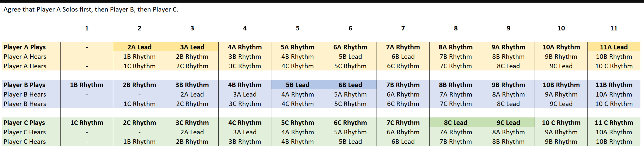

    Ninjam extends the latency by delaying all received audio until it can be synchronized with other players. This is called a BPI interval. Then you set the BPM. So if you wanted to play a 32 bars song at 160 BPM you could:
    1. Set the BPI for 32 measures, and the BPM to 40 (160 beats/4) or
    2. Set the BPI for 128 (32 measures x 4) and the BPM to 160
    Then you jam. Not really sure how to explain it. It's very different from real jamming, and it's weird that you always hear the BPI interval that the other players played before. But it works for Gypsy Jazz because you agree who plays the solos when, and everybody else plays the same 32 bars of rhythm. From an individual player's perspective it works out [if everybody plays on time :) ]. Here is an image of my understanding of how it works:
