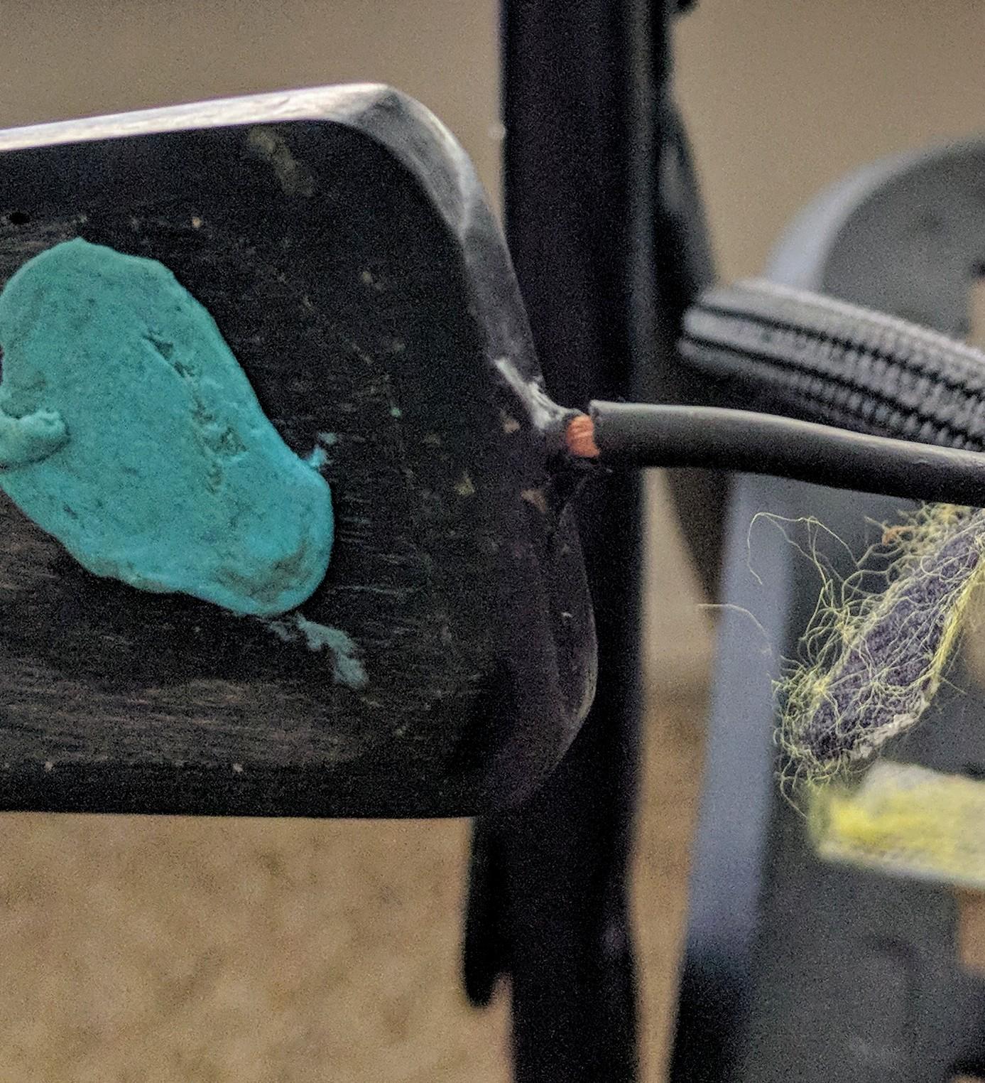

  • edited November 2017 Posts: 6,156
    I have two, use them as a single humbucker. One is like I said 10' 4". The second one is closer to what Chris says.
    I know the cables are going to break at the pickup side one day. The insulation already broke on one of them but the wire is still ok. No idea what to do when it goes...
    Gotta do some brain storming, will post if I think of something...
    PS I guess I'll just try a few coats of liquid electrical tape. Some kind of strain relief would be nice but the cable isn't much thinner than the pickup. A heat shrink tube at the time of the assembly would've been good. Maybe I'll remove a jack and slip a piece but I'm not sure if it's going to help because the cable is breaking exactly at the point where it enters the pickup.
    I'll post pictures tomorrow.

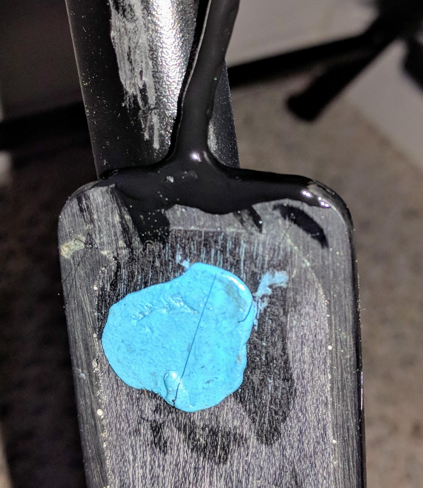

    Before and then after a few coats of liquid electrical tape. Hopefully that'll do the trick.
