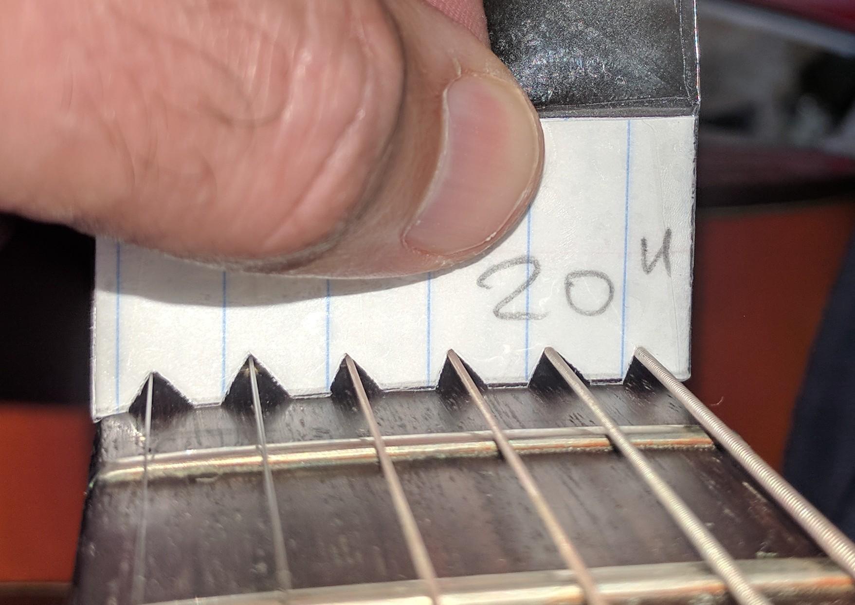

    You're right @Jeff Moore there's definitely some radius when I slide a metal straight edge under the strings. When looking by a naked eye it looked flat to me. But I guess 20" which as you say is the most common isn't very noticeable when sliced and placed across a couple of inches. I'll try to measure exactly next time I'm changing strings.
  • edited September 2017 Posts: 5,373
    My quick and dirty radius gauge seems to agree with you.
  • Jeff MooreJeff Moore Minneapolis✭✭✭✭ Lebreton 2
    edited September 2017 Posts: 476
    Buco, yeah these necks "look" pretty flat. Your gauge is great! That's all the gauge a guy needs.
