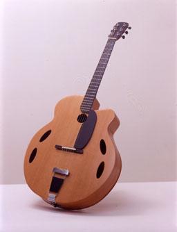

Paul is the maker of Gruen guitars, funky looking but extremely well conceived instruments.
Jeremy is a woodworker extraordinaire and a friend of Paul.
Paul had since stopped building but Jeremy sort of took over the torch to build them in his spare time.

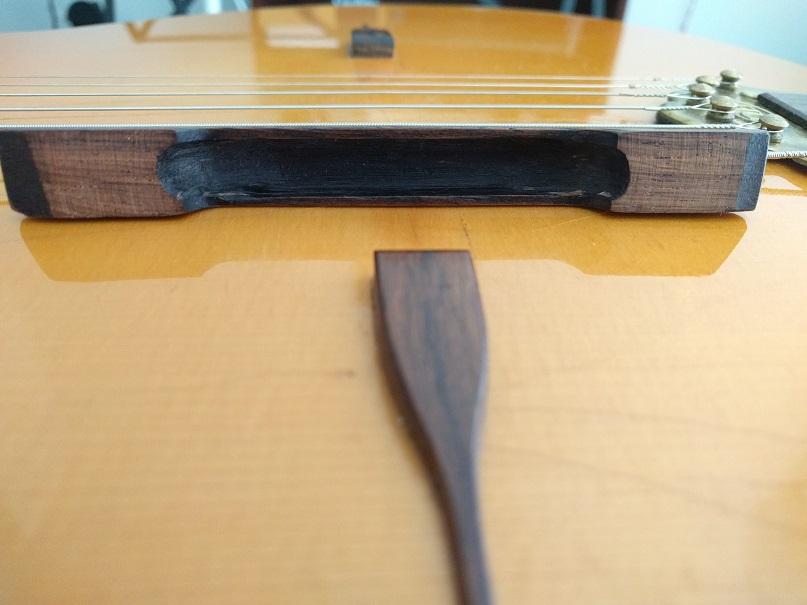

The bridge I had on the guitar was made by Dan Hunt. I was well made, hollowed from underneath better than any other bridge I've seen. The wood by itself rings beautifully, when you hold it lightly and tap it it rings like a marimba key.

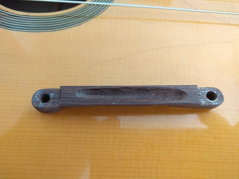

As you see, by the looks of it it looks more or less like any other archtop bridge.
So what's the secret sauce?
Well besides just being extremely well crafted and using good quality woods, the thumbwheels and post are light and strong metal. Weighs next to nothing so it's not adding to the overall weight of the bridge.
The old bridge measures 12 grams, and sometimes the scale tips to 13.
The adjustable bridge is 14 grams. And it has space to go less.

    Very Cool I Like how the Underside is Hollowed out like the GJ Bridges
