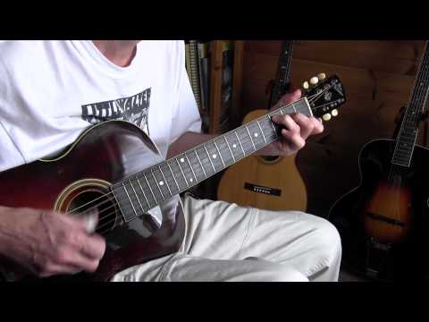

    Check out these vids of a Gibson L1 (first two) and L3 (second two):
