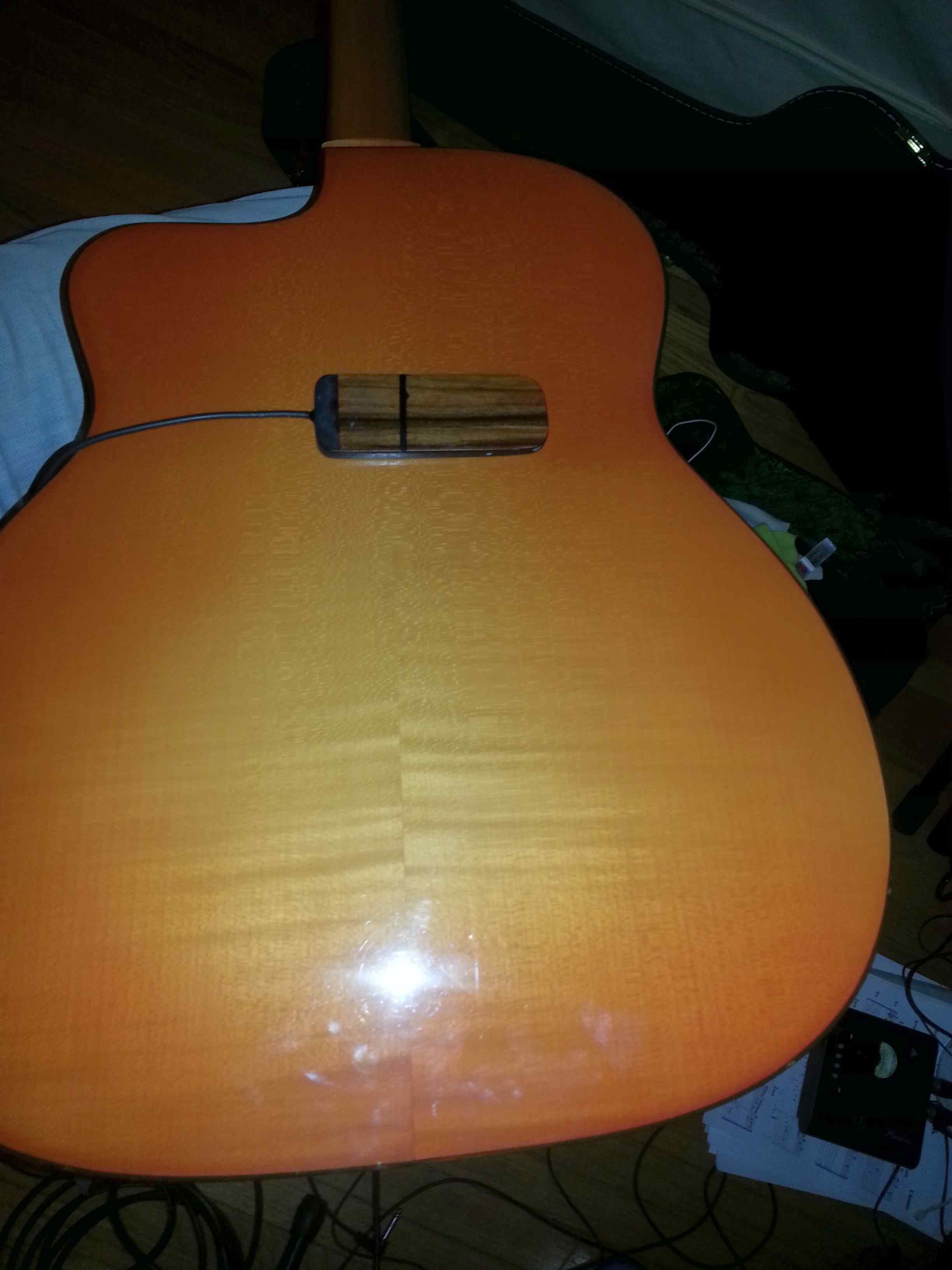

You do this: flip one of the pickups upside down, see picture
What happens is you reverse the polarity, but not electrically; physically.
And what do you know, it works.

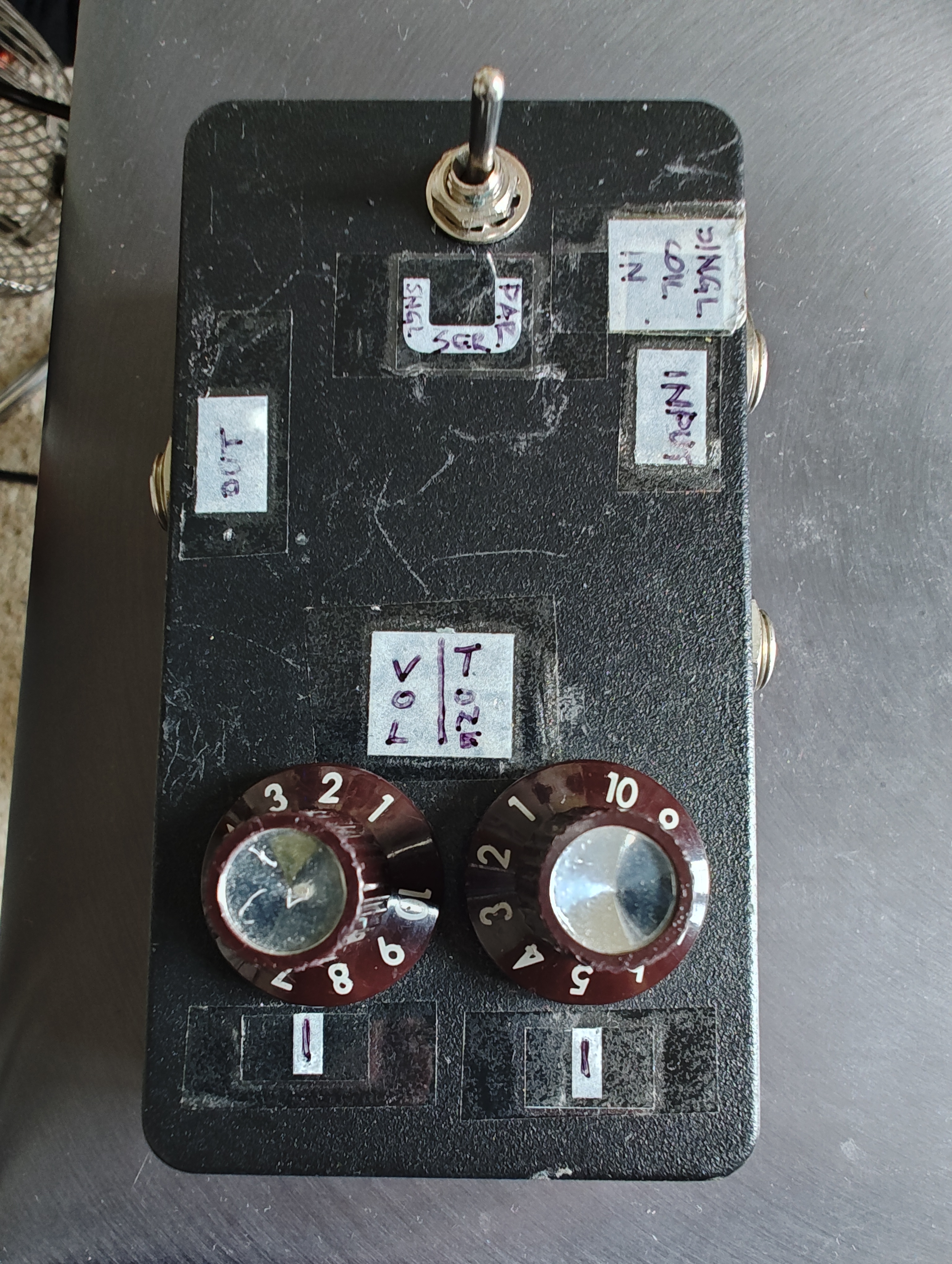

I got the little project box and made a two input/one output switch box.
I added a DPDT on/on/on switch and wired it; single/series/parallel
In parallel the noise is completely absent, the pickups are quiet a 100%.

Lastly however silly looking (only if you know it's there, others might think two Krivos next to eachother is silly looking), if you place one of the pickups on the back of your guitar, it will still preserve a humbucking properties of noise-riddance and sound great, as long as they're physically opposed to each other.
The sound will change according to where you place the pickup; closer/further to the neck though with the two sitting next to eachother you can only push it so much towards the bridge before it starts getting in your picking.

    Next is to add some pots for tone/volume and see what that adds to the mix.
  • edited September 2023 Posts: 5,752
    Just redone everything with this new box and added volume and tone pots.
    Funny thing is this way there's much less difference between parallel and serial position, they're almost identical. Another funny thing is that the noise in single coil position is now louder than originally.
    It's too late to try as I type but I'll try plugging in just one of the Krivos straight to the amp and see if there's a difference.
    I guess it makes sense with added circuitry, more wires and longer signal path but I would have never guessed.
    But in the humbucking position it is dead quiet and possibly little louder than single coil.
