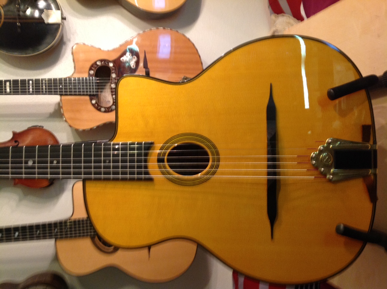

    Posts: 936
    @rgrice
    Here is what I did, worked for me, all who heard the guitar with and with out the leather thought the leather reduced the overtones and ringing. :-c
    You can cut and trim to your liking or not even use it. Your Choice
    Leather was from scrap bin @ Tandy Leather, I cut about a 1/4" strip and placed it under the tailpiece till it felt snug.
    May work for you, don't know.
    I like to tweak on my Guitars
    picture was upright on my Computer :question:
    Hope it doesn't fall off the stand now X_X

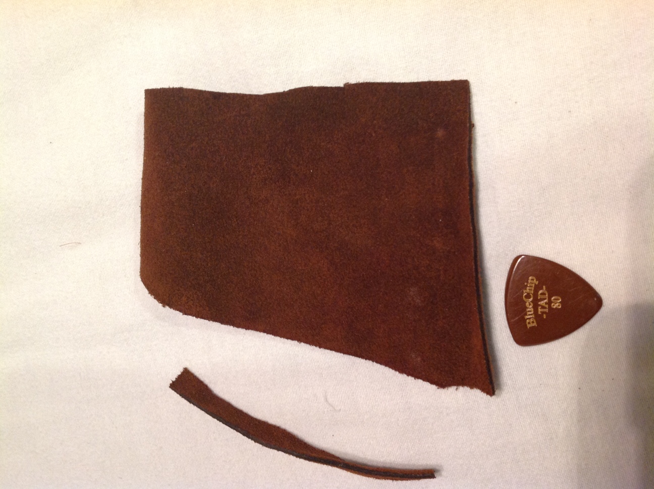

    Posts: 936
    @rgrice
    Here is a Closer look at just the leather strip
    I put a Bluechip TAD 80mm pick in the picture because it is about the thickness of the main leather piece. Strip is just a 3/8" cut about 4" long.
    BTW I love the Bluechip, best of all my picks and I've got a S***load.
