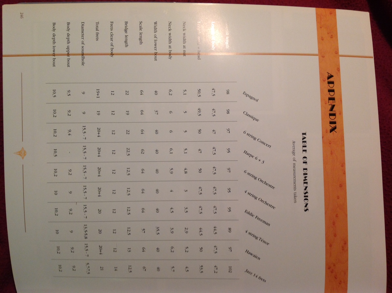

  • My Selmer story book has a table of dimensions and there are three gut string early models Concert, Espagnol and Classique...which of these are you looking for?

    Hey Miguel,

    thanks a lot guys - i really have to order the book.
    Actually, the info not only helps me but gives me some insight i lacked: didn´t know there were three different nylon (or gut) stringed macs. i only knew the cutaway/D-hole (concert?) model and suspected there was also a non-cutaway/roundhole (classique?) - maybe i heard about it here at the forum?
    now i wonder how the espagnol model looks like.
    bridge dimension are also useful.
    in case anyone is interested (well, one never knows...) i was mostly interested in knowing if the trend for larger (wider) classical guitars was a Madrid "school" thing or not. Santos Hernandez was making guitars with a 370 mm span at the lower bout by 1930.
