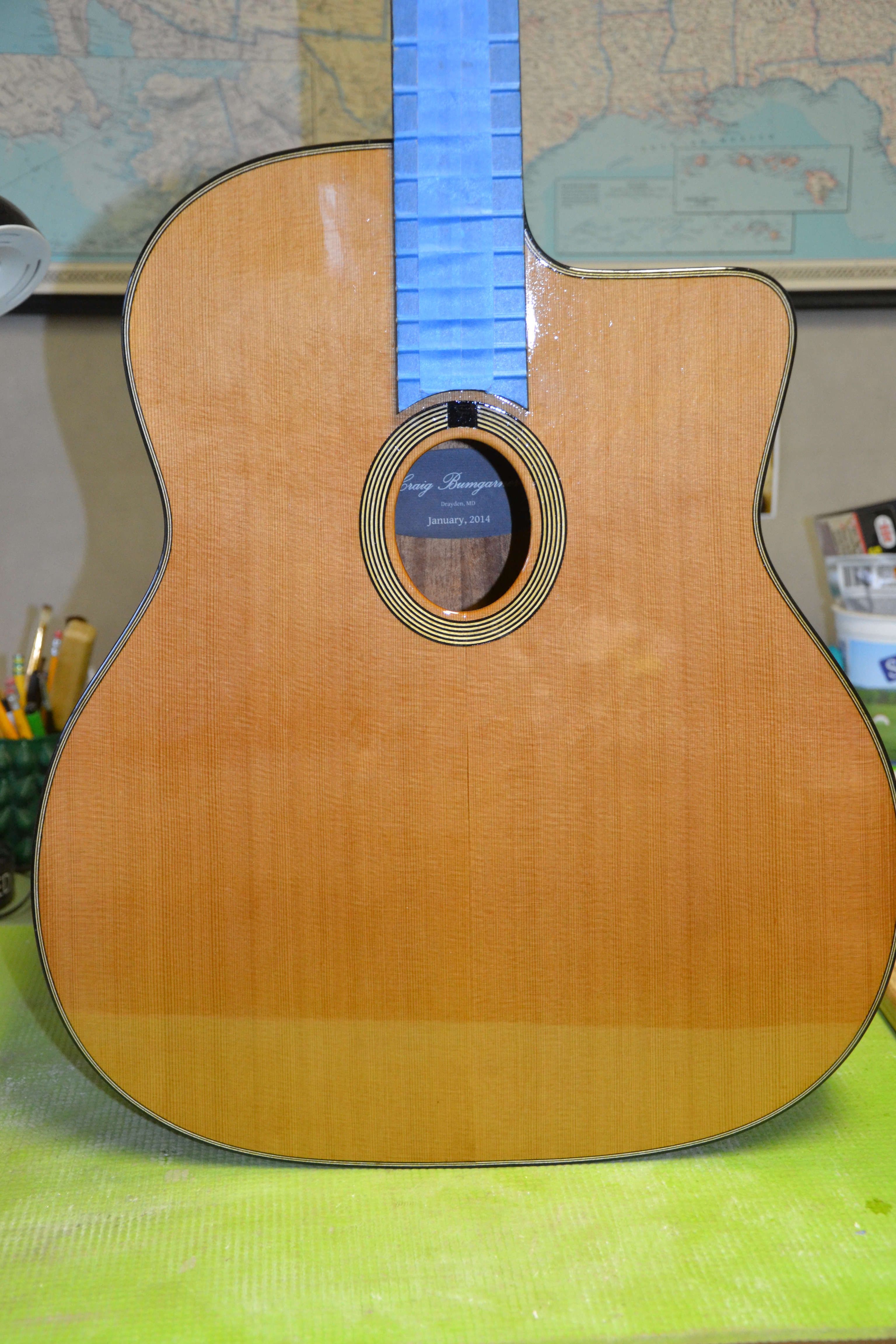

    Moving the sound hole up allows more top area below the sound hole and it is this area that is most active sound wise. It allows from more space between the braces, if the builder chooses to do so. Personally, I think these are both good things. I was unaware of Selmer's efforts in this regard, thanks for pointing this out Frank, but, I was aware of the efforts of others in this regard.
    The 1940s gypsy mystery guitar on my blog entry dated July 15th , that some believe came for the Bustato workshop, has the sound hole placed much higher than Selmer and it is a great sounding guitar.
    The J. Castelluccia style medium size D sound hole is not as "tall" as the Selmer petite bouche by 15mm, allowing the brace below to be moved "up", something JC frequently exploited. In my most recent Derecho (Coco Derecho, October 2013 on the blog), I moved the sound hole up as well, the combination yields even more top area below the sound hole.
    On the petite bouche guitar I am finishing up now, I moved the small oval hole up about 15mm to a position very similar to Selmers 645 & 625 that Frank points out, slightly above the narrowest part of the body waist. See picture below (excuse the blue tape on the fingerboard, still varnishing).
    Modern acoustic guitar builders are moving traditional sound holes around in a variety of ways: Australian guitar builder Trevor Gore moves the waist of the body and the sound hole up considerably on his steel string guitars. Some builders do away w/ the conventional sound hole all together and put openings of various shapes in the upper bout either side of the fingerboard. Most of this is to enlarge the active portion of the top in an effort to increase the volume and affect tone (for better or worse).
    All of this also helps center the bridge in the active portion of the top, something a 12 fret guitar accomplishes with more ease and may be why many 12 fret guitars sound so good.
