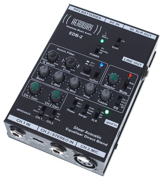

    If I cant use that I use an EDB which can properly deal with a microphone7981296_800.jpg
