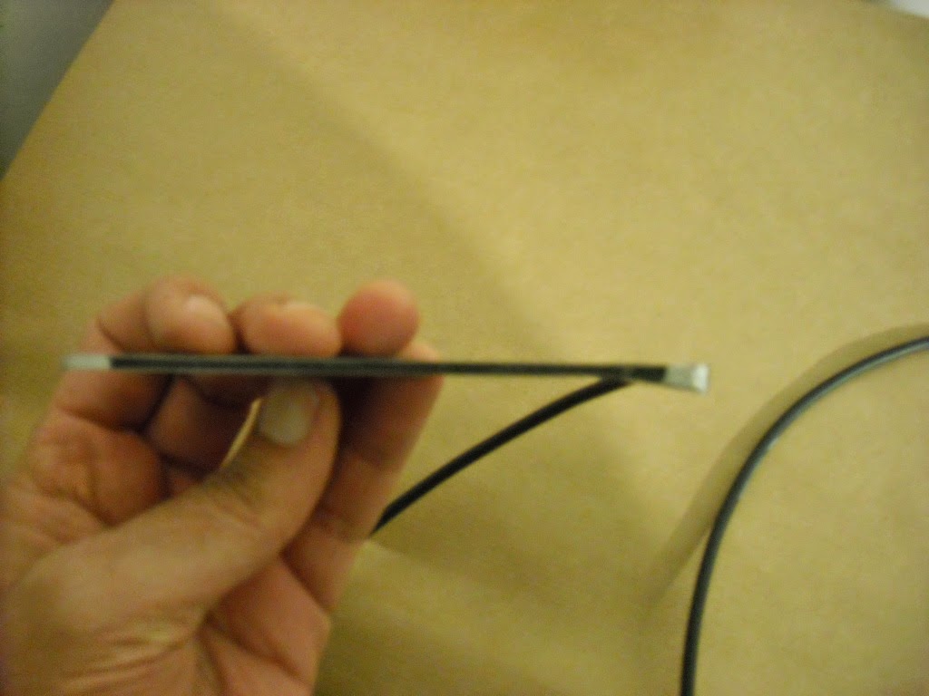

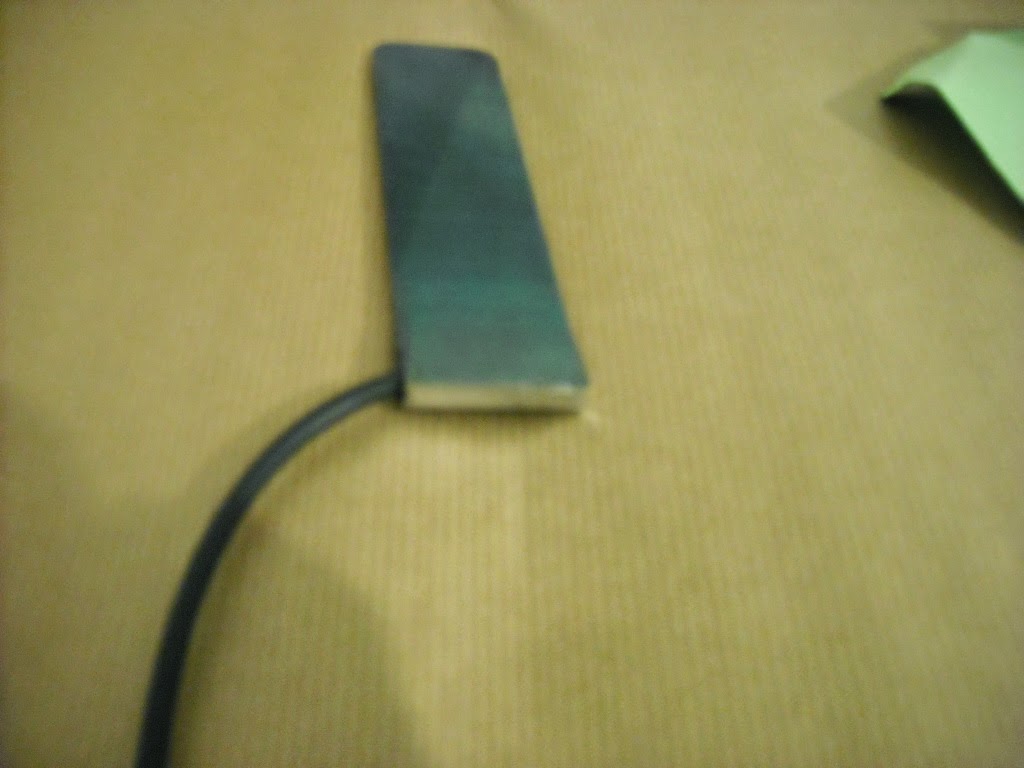

  • surdopickupssurdopickups Galatina - (LECCE) - ITALIA
    Posts: 39
    the pickups are manufactured in two versions
    1) impedance <400 ohm, balanced cable, XLR connection
    2) +/- 1.2 ohm impedance connection 1/4
    some photos during construction
