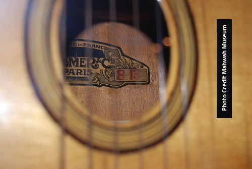

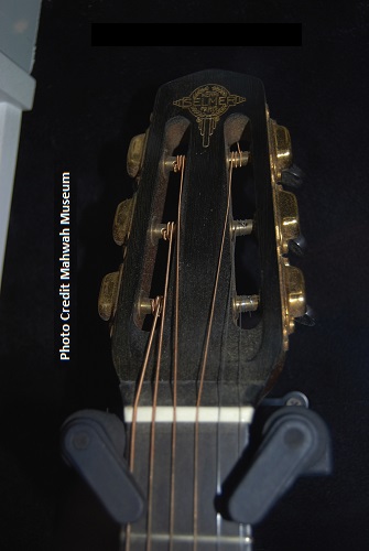

    I spoke years ago (in 2014) with John Monteleone about this Les Paul's Selmer.
    Actually the guitar is in exposition at the Mahwah Museum 201 Franklin Turnpike, Mahwah, NJ 07430, United States
    The guitar is a true Selmer nr 813 dated 27 March 1950 and sold to a man named "Delplace". We do not know exactly how Django got this Selmer. The guitar should have been then given by Django's family (Naguine) to Les Paul after Django's funeral.
    Here's what Monteleone told me:
    A few years ago John often worked at his neighbor's Mario Maccaferri home on a guitar project and one day on his way to the men's room he walked through Mario's (Maccaferri) drawing workshop and saw in front of him this Selmer nr. 813 placed on a shelf waiting to be repaired on behalf of Les Paul. Mario never had time to take care of it so he readily accepted, just like Les did, John's proposal to take care of that guitar directly.
    The guitar was in poor condition, the fingerboard had already been changed and the position of the bridge was no longer good, the neck was also twisted and had significant cracks on the base and in addition Les had cut the harmonic table to embed a microphone in it. He said the guitar was indeed one of Django's personal Selmers. Les had gotten it from Naguine at the time of Django's funeral in gratitude for his help in organizing the funeral and for his lifelong friendship with Django.

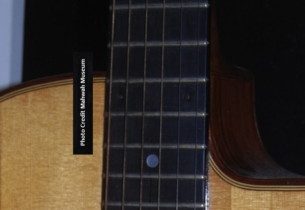

    Les therefore expressly asked John to remove the zero fret which he did not like and to change the fingerboard to put a radially curved one and he also wanted a very low string action and finally an adjustable neck. So they had the idea of ​​putting a truss rod with a small block of ebony at the 15th key to very easily adjust the neck without changing anything on the head side. The top was then repaired to eliminate the hole and reinforce and then rebuild the soundhole by removing the top and repairing the cracks in the harmonic board... it worked perfectly, he said, and that's the whole story!
    Mike at the Mahwah Museum very kindly sent me a few photos to show the repairs on the guitar.
    With an effort you can see the two screws at 15th fret for the neck regulation

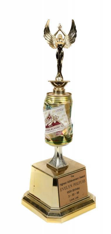

    Thanks for the link, @wim. So, somewhere out there, this guitar is floating around. Too bad I wasn't around to purchase this trophy. Ha ha...seriously...~$900! I can think of better ways to spend my coin. They could have bought my Altamira AND had change left for a case of Blatz/High Life. It's the Champagne of Beers.
    https://www.julienslive.com/lot-details/index/catalog/71/lot/27216/LES-PAUL-NOVELTY-TROPHY-amp-PHOTOGRAPHS?url=%2Fauctions%2Fcatalog%2Fid%2F71
