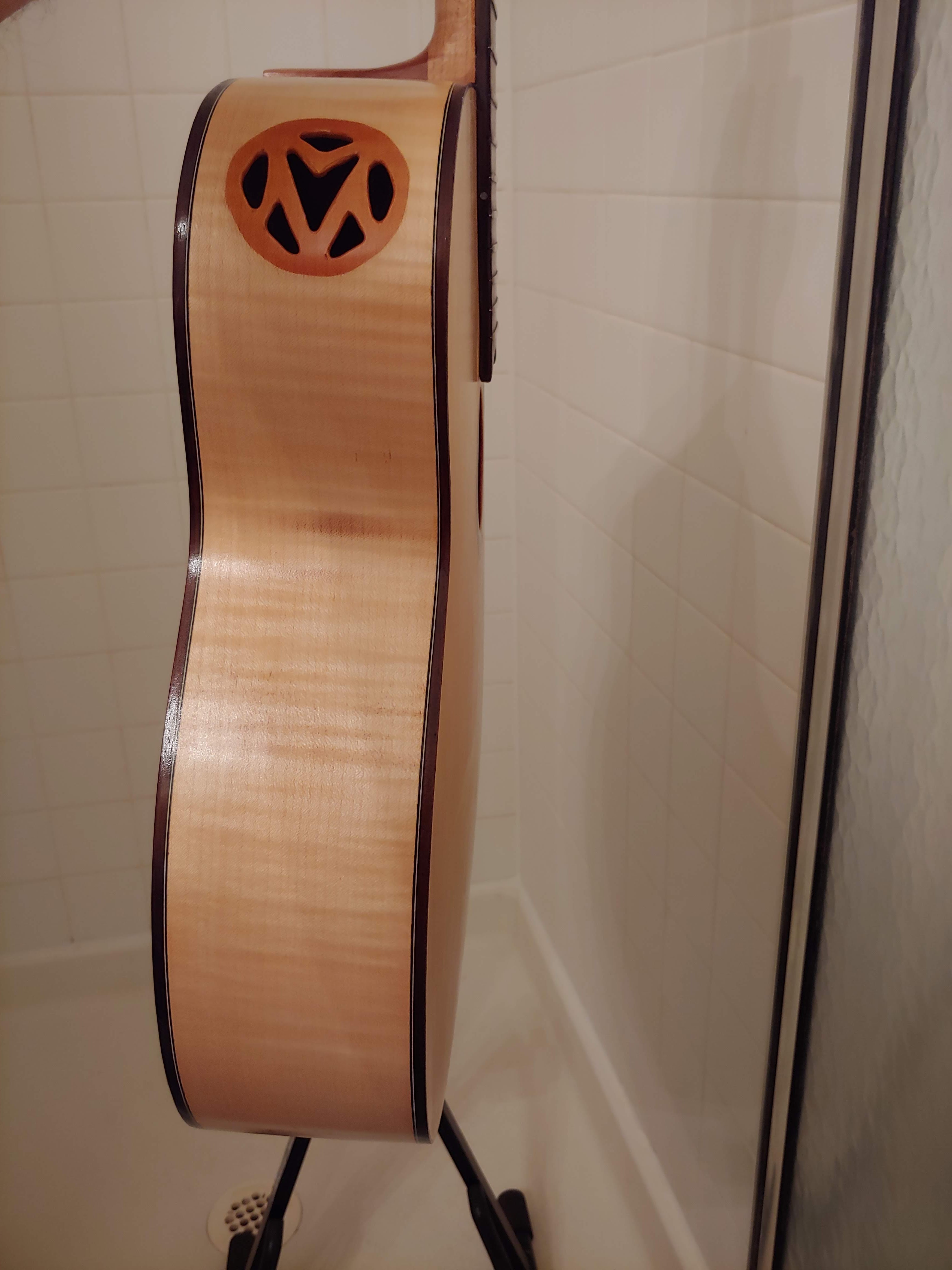

  • Posts: 5,786
    Just a happy user here.

  • Posts: 5,786
    This is from when it was drying when I was refinishing it. Sometimes I do stick it in here (steam up the shower beforehand) if I need to give it a quick humidity boost.

  • Posts: 5,786
    Thanks Bill. People try it and while playing I cover the soundport and they're surprised at the difference.
