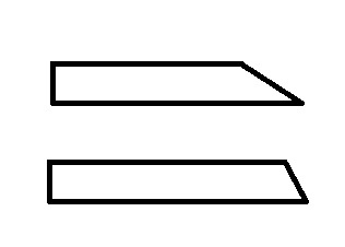

    Thanks for the video! I've made Gypsy picks from Kirinite and posted about it in other threads here. It's an easy material to work with and seems to be pretty durable. One thing I've found is that the angle of the bevel is critical to the sound. Two picks that look pretty similar can sound different based on the bevel. A more acute angle will make the pick brighter, and less of a bevel will make it darker.
    If someone wants to get into this, the main thing is that you want to start off with a cheap material, because it's going to be a learning process. I use a small coping saw to rough out the shape, a Dremel with a sanding disk attachment to get it to the final shape and size, and a small file to form the bevel. Then I use some sandpaper and the nail buffer to polish the edge. I have tried making a jig to get the bevel more consistent, but it's still a work in progress.

    What do you mean by "acute angle," as it applies to the pick?
  • flacoflaco 2023 Holo Traditional, Shelley Park #151, AJL Quiet and Portable
    Posts: 289
    Terrible picture for effect: all other things being equal, the pick with the sharper bevel (top) will be brighter sounding.

  • pdgpdg ✭✭
    Posts: 658
    Thanks @flaco , for the drawings.
    I've noticed that it seems there's a complicated relationship between lots of variables. I still haven't figured it out. Is there a school of (GJ) pick-making (like bow-making)?!
    Here are some of the variables that I've observed affecting tone and playability.
    -- bevel angle, like you say,
    -- bevel "depth" (sand all the way down to a knife's edge like in your drawings, vs. leave some "meat" on the other side of the pick),
    -- bevel shape (straight line, vs. curve down (becomes more perpendicular) as it meets the opposite side),
    -- tip shape (radius),
    -- pick thickness.
    -- the final result: looking head-on at the beveled tip, it looks like the business end of a screwdriver, so what is that resulting shape -- width, sharpness, angles?
    Also, these things not only affect tone, but also seriously affect playability. I've found that a too "acute" bevel, or too deep a bevel, can cause too much resistance in playing followed by too much "explosion" felt by the thumb and index finger. It can make a pick feel like it's too thin, doesn't play smoothly.
