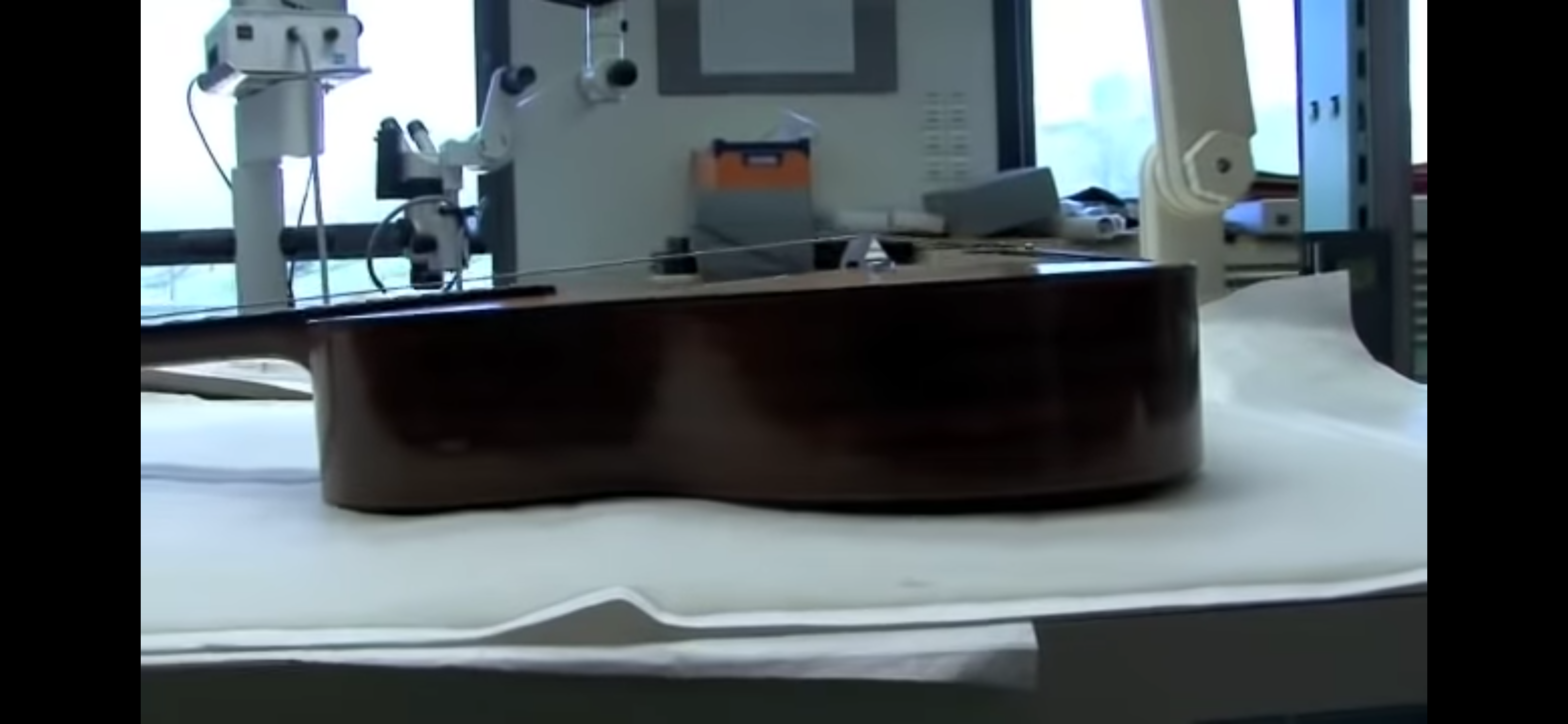

    we're trying to do a straight up 503 replica.
    does anyone know what those radii are?
    (incidentally, have studied the well-known '503 - a closer look' YouTube video [freeze-frame / zoom etc.] and can't for the life of me detect the presence of any kind of 'pliage'.. ??)
  • Posts: 5,842
    Look at the hump right by the bridge, it's at 4:05

    Thanks Bones - so am I right in concluding that once the top is bent down to meet the sides, the 'pliage' sort of ends up as more of a (almost undetectable) shallow and rounded curve, as opposed to a 'peak' with a visible (relatively sharp) centre line'??
    Forgive me, I've never seen a gypsy guitar 'in person'..!!

    I'm not a builder but I've seen guitars with pliage looking like a sheet of paper that's been creased and ones that look like they have a beer belly. It depends on the technique used and both looks can be the result of a pliage. Then you have a forced top that's also very common and some builders prefer it. It's easier way to go about it and certainly can result with a great sounding instrument.
    As far as I know the way Selmer factory did pliage isn't precisely documented.

    Blue, are you planning on bending an actual pliage (fold) or are you just doing a domed (rounded or arched) top?
    The pliage is pretty noticable, it is not a sharp corner but a very small (about an inch or so??) radius depending on how small of a diameter pipe you bend it over.
    Typically it is plainly visible from the side, or for a finished instrument with a gloss finish you can see a shadow in the correct light and angle. The shadow will show up just behind the bridge. Probably the reason you don't see it on 503 is the finish is so dull from age and scratches that it doesn't reflect the light very well. I'm not an expert and I have never held an actual Selmer but I think all the originals had a fold (pliage)???
    I'll try to post a picture later.
