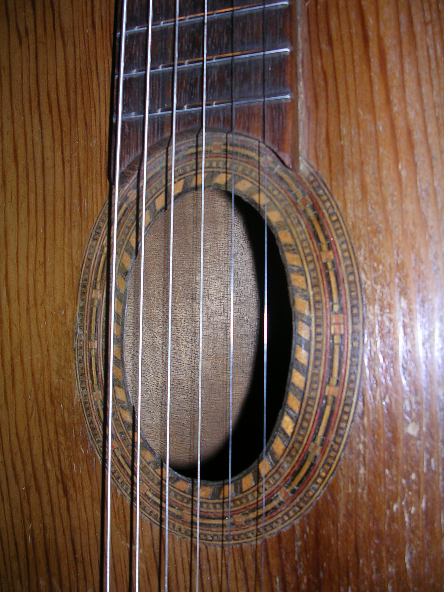

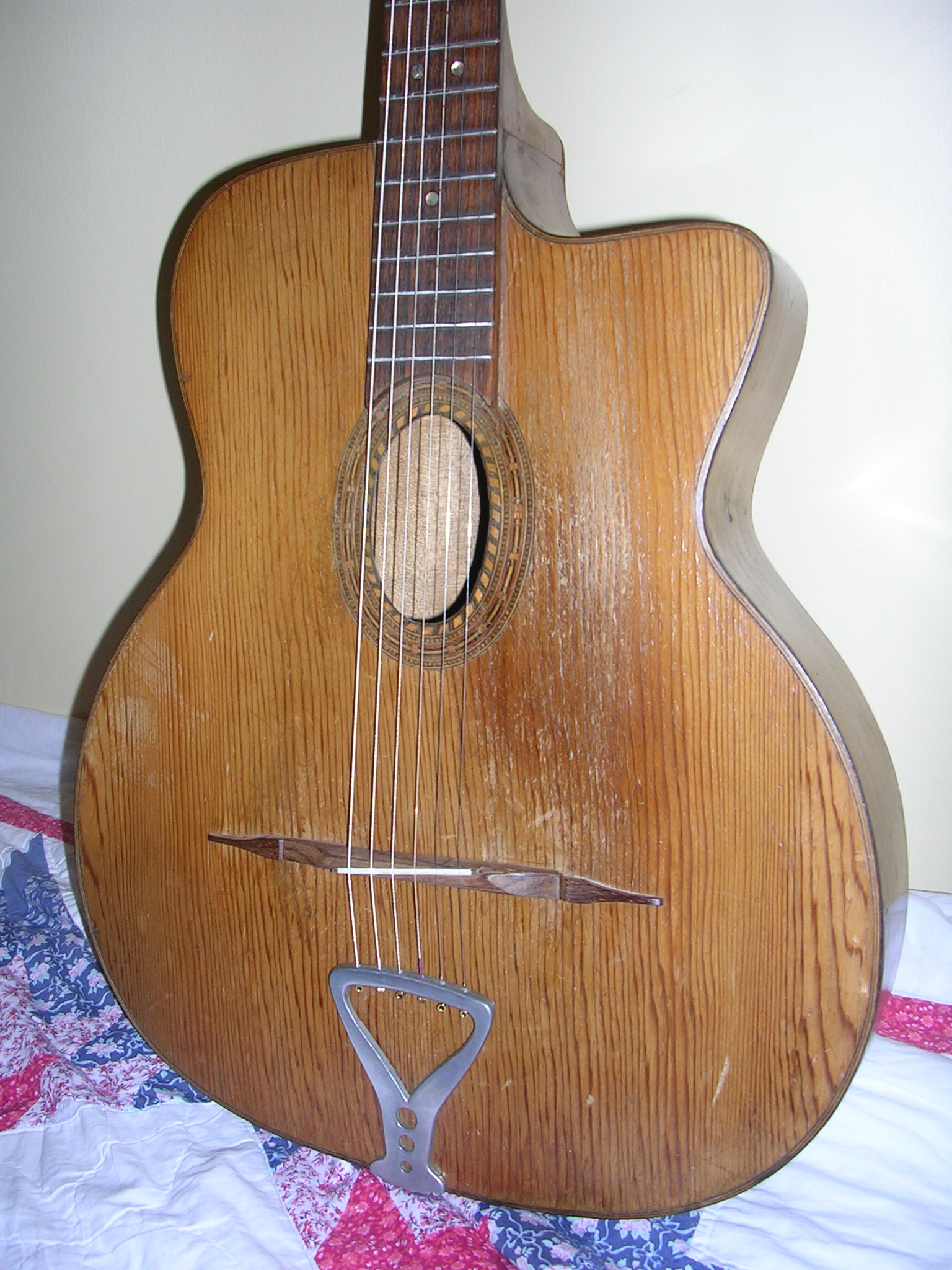

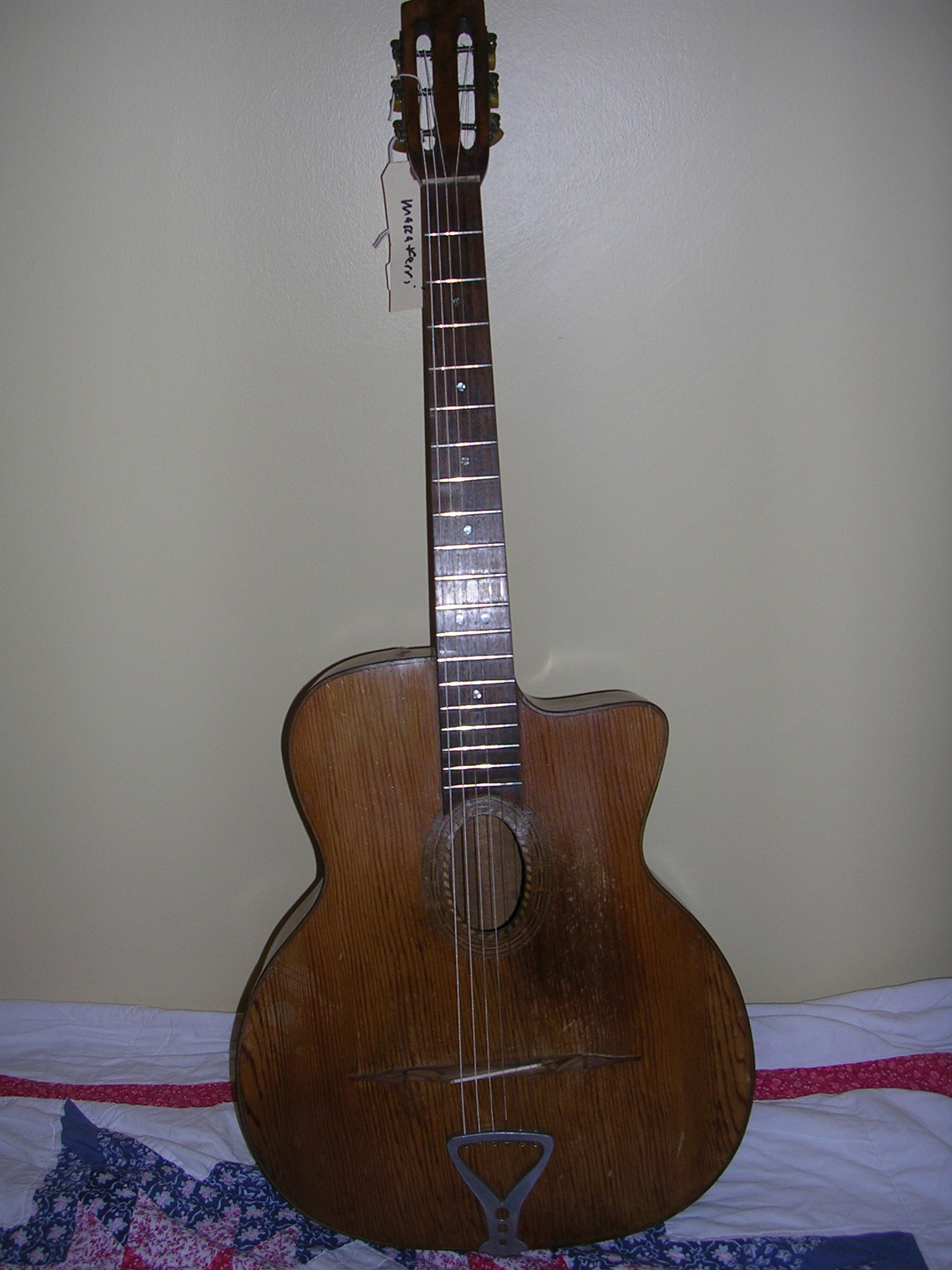

I recently bought a gypsy jazz guitar from the Jim Fisch collection however I do not have any idea what type it may be. There's no type of label to speak of and it has some odditys that have me confused. For one, it has a 13 fret neck. For another, it has a pretty complicated inlayed rossette that I havn't seen before on a guitar like this. My first thought was Dimauro but the neck doesn't look right and the headstock doesn't either. So...who knows? The spruce of the top also has a very fat grain like I havn't seen before. Here comes the sad part... this guitar arrived to me pretty messed up thanks to our pals over at UPS. the back was peeling off and it had two major cracks in the left side. My luthier is pretty confident he can fix it and UPS will pay for all of it but it sucks because I havn't even got to hear it yet!!! One thing the seller did tell me was that Jim Fisch sold his Dupont once he got this one! Pretty cool. Let me know what you guys think! Thanks! With any luck I'll be able to attach some pictures...we'll see!

    Well that's an interesting guitar. I can't tell you for sure, but here are my first impressions.
    1.) Body shape is like a slightly exaggerated DiMauro Sr. The waist is similar but the lower bout is too big proportionally... how far is it across the lower bout? 15.875" or more?
    2.) Bridge is reminiscent of an old Pat? odd. Not sure what to make of it.
    3.) Soundhole shape and placement is reminiscent of a handful of old Busatos that I've seen (and one that I own)
    4.) The wood is similar to early Mirecourt era guitars I've seen and worked on. Wood was not all that plentiful - tough times back then in Europe which forced them to use every piece of good sounding wood regardless of how ugly it was... and by the way I salute that... the correlation between good wood and pretty wood is not as high as many would believe.

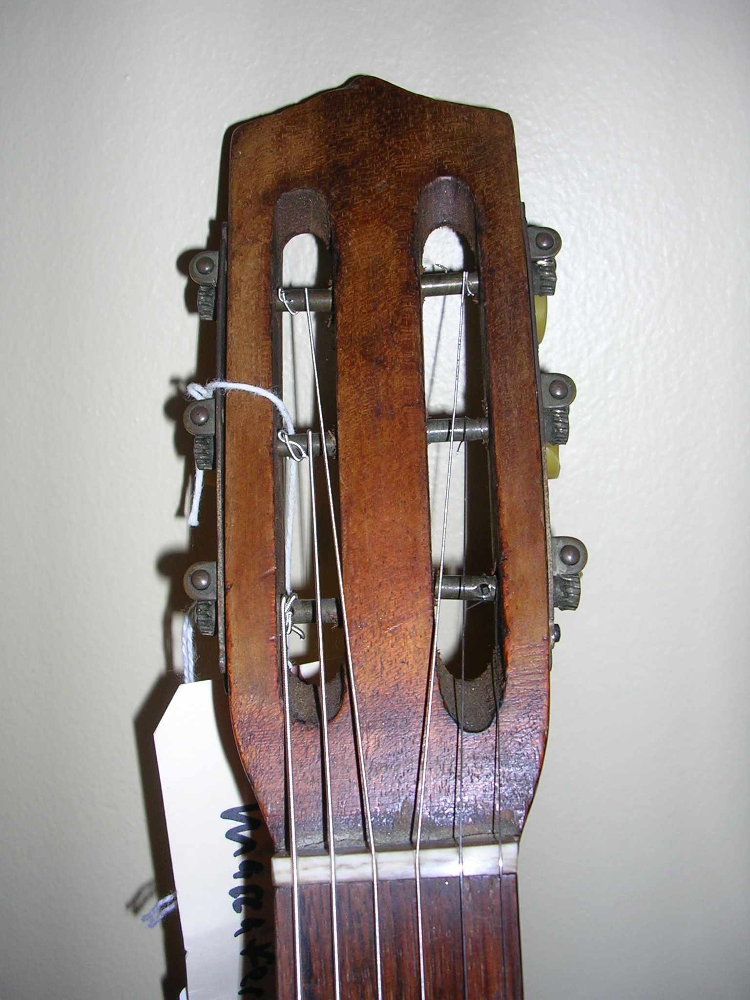

    5.) The tailpiece is reminiscent of those found on the Sonora guitars out of Spain - which in and of itself doesn't mean anything - it was likely something that could be bought in many places. But more compelling is the headstock which is also like the Sonora. If I had to guess, that would be my guess. Hono Winterstein used to play a Sonora - now owned by Vic Wong who posts on this board under V-dub. compare notes with him and see what you find.
    It would help to see the back of the neck, the back of the headstock joint, the back of the heel where the neck meets the body, the placement and type of dots on the side of the fretboard, and any labeling or notation anywhere on the guitar. A closeup of the binding and the back of the guitar body and a general description from you regarding the amount of arch on the soundboard and back would also be helpful, but unless I saw something completely unexpected in those photos, I'd take a WEG (wild but educated guess) that it's a Sonora.
    One thing is for sure, whoever built it was familiar with the work of several European builders of his/her day and was trying a few new things out on this one.

    thanks so much for the prompt reply! I guess in some ways the mystery continues. All else I can say about it is that both the back and the front have some arch to them but the back has slightly more. It has the old school tuners that turn backward, and it has no markers on the side of the neck. It has not one marker or label or number or anything on it. Also, that isn't the original bridge, some jerk decided to "install" their own shadow (i think) type pick up in the original bridge. I don't know if this helps and to be honest, I suppose it doesn't matter who made it as long as it sounds good and plays well. I think the little beat of a beating that it has taken adds to the character of the instrument, though I didn't want UPS to add to it! Actually, I have a luthier question for you Bob, if you don't mind. My luthier thinks that it may be a good idea to put in some type of brace to help ensure that the top does not bow any more than it already has, would you agree that this is a good idea? Also, I was thinking that I would just have him build me another new bridge to replace the shitty bridge that someone put a pickup in, what do you think? I don't think this old beauty deserves any electronics in her. If necessary, I'll throw a stimer in!
