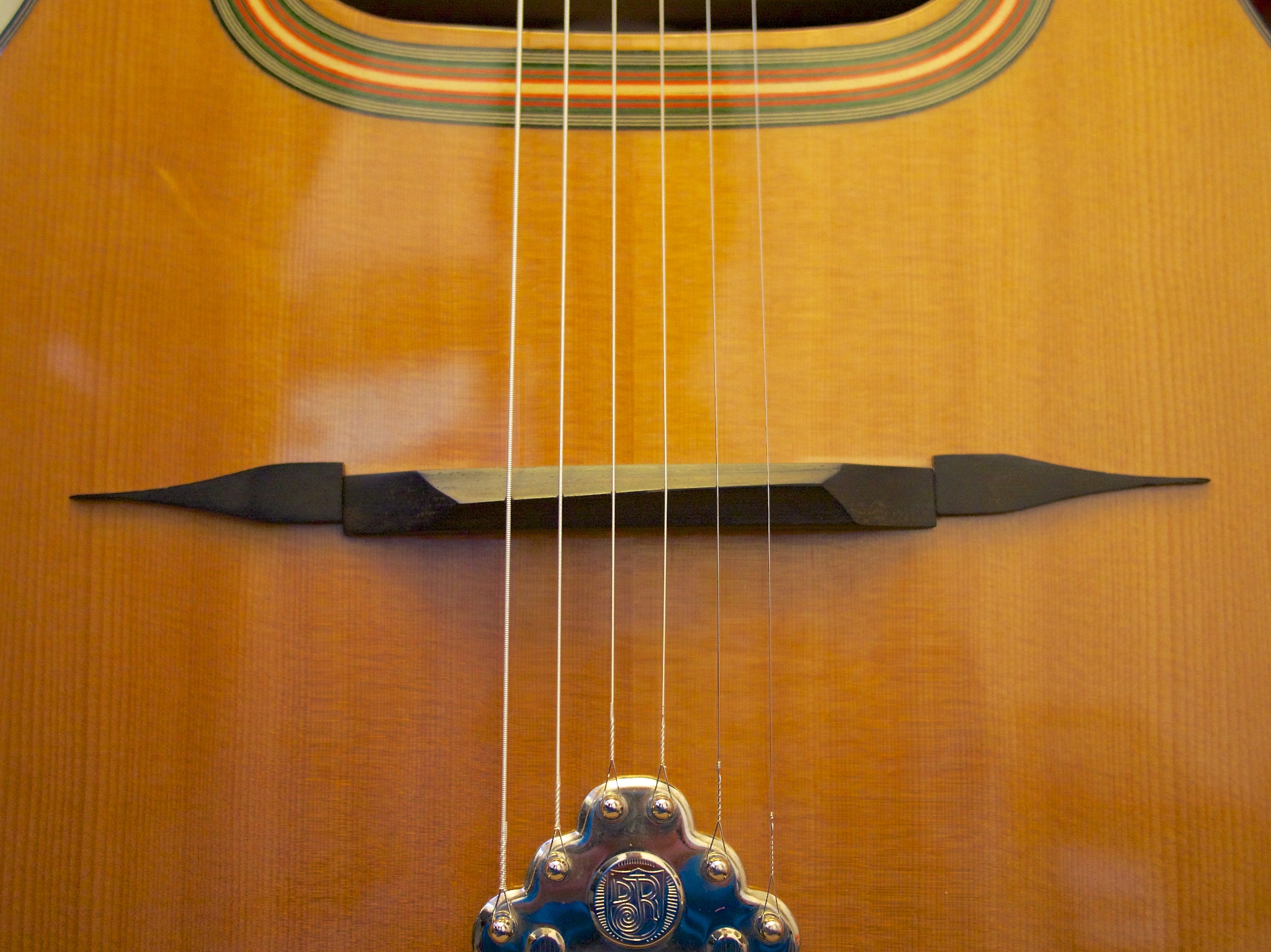

    Perhaps also you could post a pic of the bridge from above

  • Hi, thanks for the replies.
    Yes, I measured the sharpness at the 12th fret, and the action on the G is just over 2.5 mm there (difficult to be more precise than that as I'm using metal ruler with 0.5mm markings).
    A bad G string? Not sure what to say ;-) The D'Addario G is a slightly heavier gauge than the Argentines, whereas the other wound D'Addarios are slightly lighter gauges than the Argentines. All only small differences though, but could that be a cause? I'll try them next anyway, but I was hoping not to have to change strings so quickly.
    A couple of photos are below if that helps. Regarding modifying the bridge, I guess I would need to start with a new one as suggested as the top of the bridge isn't particularly wide.
    Thanks for the help!
    Chris.
  • edited December 2013 Posts: 3,707
    Thanks for the pics. There are two ways to adjust for the sharpness on the B string. Every string gets stretched a bit when fretted, if the frets are high pressing hard can accentuate this. I am assuming that there is no weirdess about the 12 th fret. To confirm this if the intonation is also out on the 11 th fret.
    The B string needs to be a little longer when fretted so the bridge at the B string needs to be set back a bit. You could try a different brand of strings to see if that helps and also go up to 11's ....maybe try Argies or other brands. I suspect that given the amount of correction needed you will need to adjust at the bridge.
    Given that there doesn't seem to be enough material left on the bridge and the action is pretty low you will likely need to get a different bridge with the b string notch adjusted back by a luthier. There has to be enough material left on the blank to allow for a few mm of backset.

  • Hi, thanks for the advice. No, nothing weird about the 12th fret - it gets progressively more out the further up the neck you go. I'll look at sourcing a new bridge then, although I think I'll play it as it is for a little while longer then see whether the other strings exhibit the same phenomenon first.
    Chris.
    edited December 2013 Posts: 713
    I'm going to jump in on a subject that is a bit out of my league and make a couple of suggestions. Before buying an expensive Dupont bridge, I would buy a couple of inexpensive rosewood bridges like these from China and experiment with them. First thing I would try, however, would be to shim the foot of the bridge on the treble side with a thin wafer of wood to raise the action a tad, which should increase the string length, and then proceed to adjust the bridge position, especially on the treble side, to get the treble strings in tune. I assume that over time the groove in the bridge gets deeper which shortens the string length and could change the intonation. A simple test would be to raise the G string with a piece of folded paper or a toothpick and see if that might bring it back in tune.
