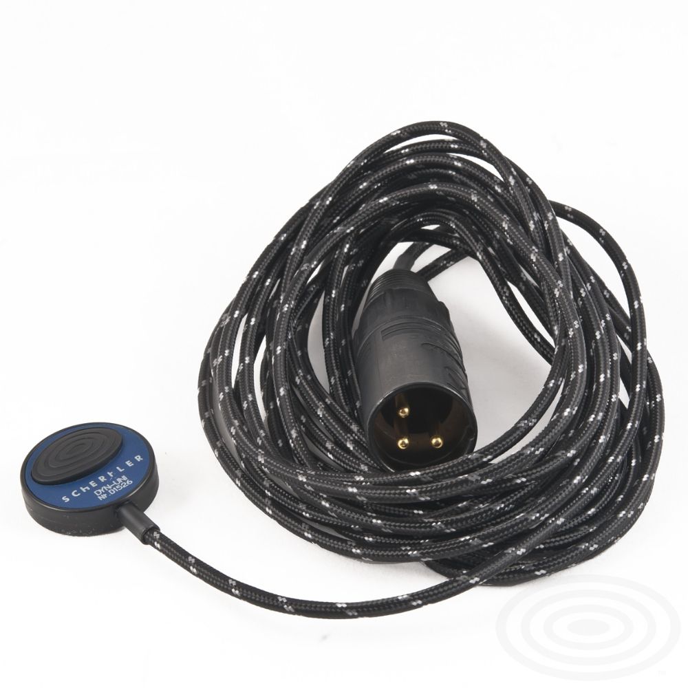

Schertler’s new DYN-UNI is a fully balanced, passive dynamic contact microphone that does not include an active preamp and therefore requires no phantom power. It features passive filtering technology and has a modified frequency response to guarantee a linear result.
The DYN-UNI has a new sleek, lightweight design and is supplied with Schertler’s own customized cable that has an extended length. The cable is both robust and torsion resistant, designed to withstand the rigours of daily use while delivering best possible performance results.
The DYN-UNI can be easily and safely applied to even the most valuable of instruments using special adhesive putty. It can also be quickly transferred between instruments during performances or recording sessions.

Output impedance     380 ohm @ 1 KHz
Frequency Response     20 Hz to 18 kHz
Dynamic range     139 dB, 145 dB typical
Sensitivity (on instrument)     ca. -38 dB
Sensitivity (theoretical)     8 mV/g
Mechanical decoupling     Butterworth 2nd order, Q=6
Temperature range     -20° C to +70° C
Contacts     All hard gold plated 0.5 mm
Connection     XLR balanced
Cable Length     4m
