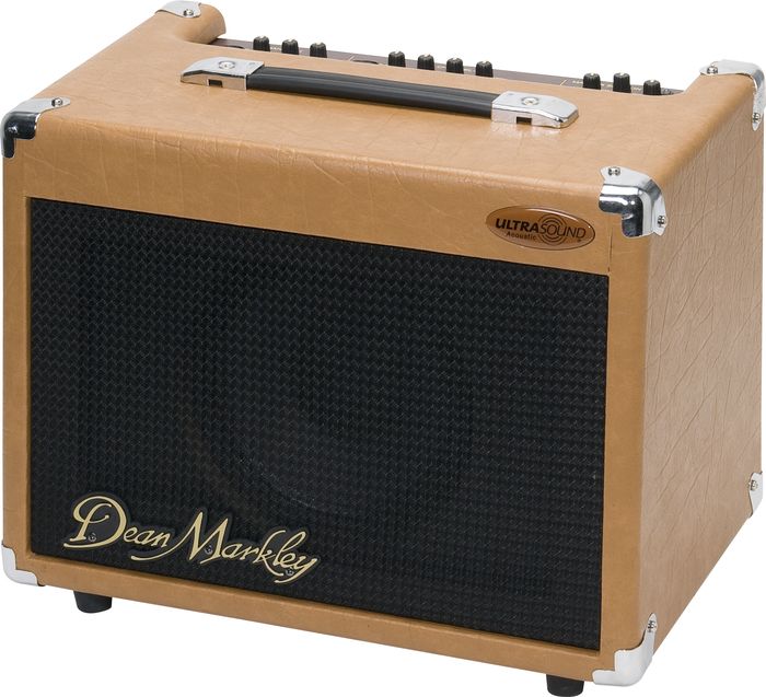

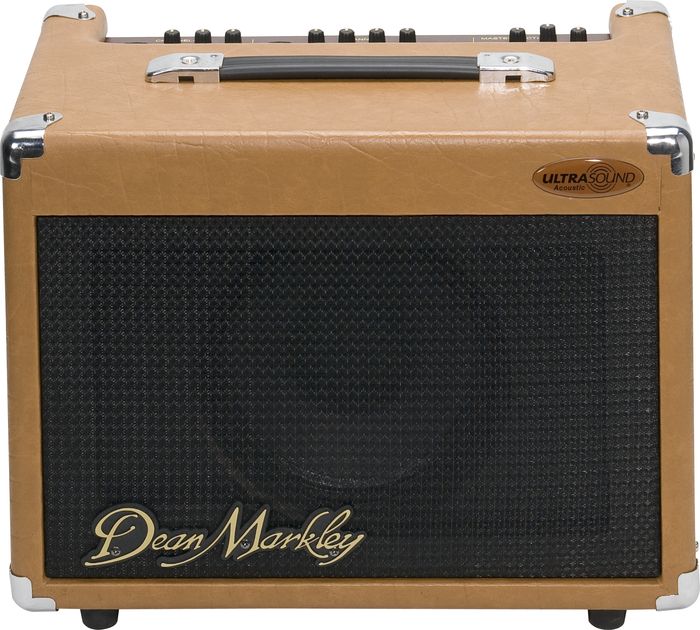

The Ultrasound CP-100 is a compact, powerful 2-channel amp that keeps your amplified acoustic guitar sounding acoustic. It has an 8" LF driver and HF horn powered by 100W. 2 channels each have combo XLR/1/4" inputs so they can be used for either guitar or microphone, and the inputs also have phantom power for condenser mics. Each channel has 2-band EQ, and channel 2 has a notch filter for eliminating feedback, as well as a shape switch that scoops the mids. A bank of 16 digital footswitchable effects (reverbs, delays, flanges, choruses, auto wah, and rotary) can be assigned to either or both channels. Other features include effects send/return, an unbalanced line out for connection to a mixer or slave amp, and a balanced DI output for connection to a recorder or sound reinforcement system.
