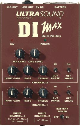

Preamp-DI MAX is the most versatile instrument pre-amp on the market. With 2 independent channels, the DI MAX can be used as a blender as well as a pre-amp. The Channel-1 input will accept mono as well as stereo (TRS) inputs which allows the DI MAX to process the tip signal through the Channel-1 controls and the ring signal through the Channel-2 controls giving you an enormous amount of flexibility for creative signal blending from your stereo pickups. Of course you can plug 2 different instruments into the DI MAX and blend the signals. Channel-1 also allows the use of an XLR input so you can use the
DI MAX as a personal mic pre-amp.
The DI MAX lets you dial in a clear, natural sound and route it to a stage PA from a balanced XLR output. A Line out sends the signal to your stage amp. Tone controls include active bass and treble EQ, mid-dip shape control, and phase switch. Operates on
48V phantom power, 9V adapter, or 9V battery.
Full-featured stereo preamp and DI box
Bulletproof metal housing
Input gain control for each channel to allow proper
setting for the huge variety of
acoustic pickup output levels
Balanced XLR output for routing the signal to a PA
system
1/4 Line Out for sending the signal to a stage amp
Both stage and PA outputs have their own level controls
48V phantom power capability
Active bass and treble EQ for each channel
Mid-dip shape for each channel control permits removal
of honky
Phase switch for each channel to help eliminate
feedback
