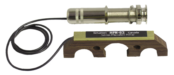

Schatten HFN-S2 Player Pickup for Selmer / Maccaferri (passive)

Design
The HFN-S2 series of pickups utilizes an elegant combination of wonderful materials: rosewood for its main structure and arching with a light weight brass shell for its noise shielded piezo unit. Total weight of the pickup is a very light 0.3 ounces (9 grams). It will not affect the acoustic sound of the instrument when not in use.
Installation is easy and quite straight forward. No bridges need be replaced and there are no changes to the playability of the instrument. All HFN-S2 models come prewired and ready to install.
Each pickup is hand built and tested in our workshop to ensure good sound. As well, each pickup is warranted for a period of two years from date of purchase.
Schatten has redesigned their 'S' series of Selmer pickups to make them compatible with virtually all Selmer style instruments. While they were at it, they made the installation of the pickup easier and quicker (even in the petite bouche). They've utilized this cutaway of a Selmer soundboard to show the placement of the new HFN-S2 pickup. The pickup mounts on the two large transverse braces that form the main structure of the bridge box.
The pickup is held securely in place with our special mounting putty. This mounting is quick and very secure. The pickup may be removed easily however, at any time should you want to move it to a different instrument.
