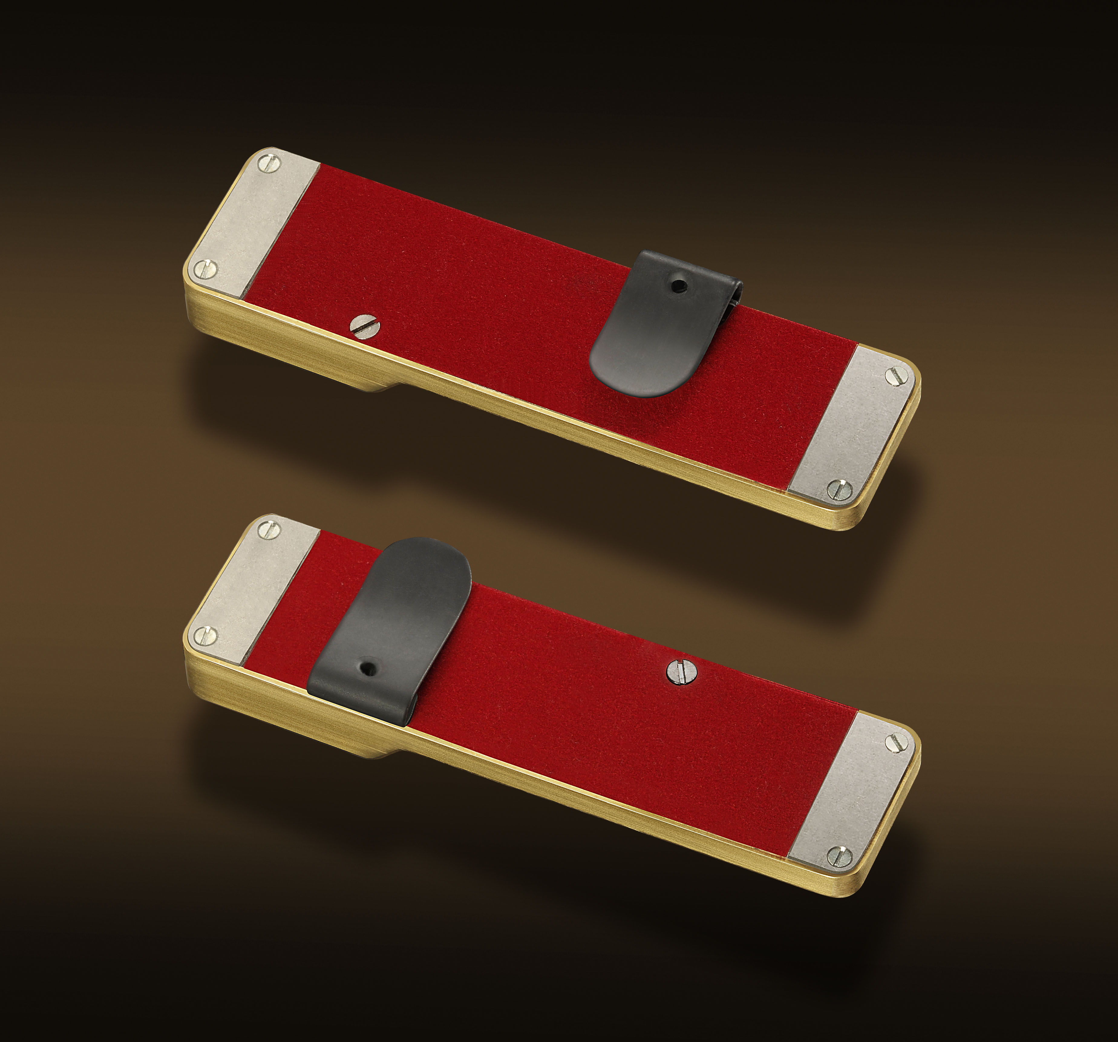

Inspired from the model used by the famous Django Reinhardt, this new model built for the 100th anniversary of Django's birthday features considerable technical improvements.
It is now possible to play "magnetic" on gypsy strings without volume difference between plain cords (E B) and wound cords (G D A E)
The pick-up is specialy designed for the type of strings used on gypsy guitars. (for gypsy strings only !)
The mounting system works with a leaf spring and is easily fixed on the instrument with the volume potentiometer towards the top.
A second spring of different length is supplied and can use the same pick-up on a "big hole" guitars.
The leaf springs are screwed under the pick-up.
Technical specifications:
  • Single coil pick-up
  • ALNICO Magnet
  • Brass Casing
  • Steel cover
  • Integrated volume potentiometer
  • Dimensions: 130x35x6.5mm
  • Neutrik 6.35 jack
  • Neutrik 3,3m cable
  • Two mounting leaf springs according to the guitar choice
  • Available in left handed version on request (potentiometer towards botom)
