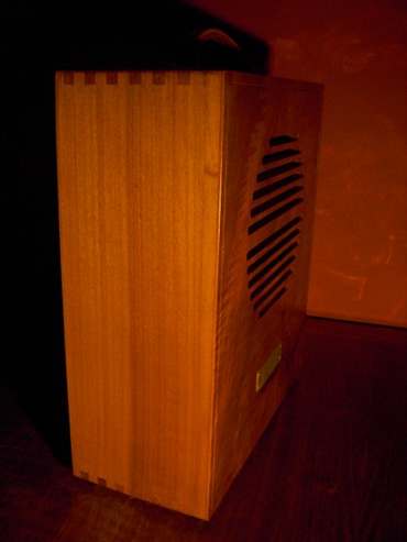

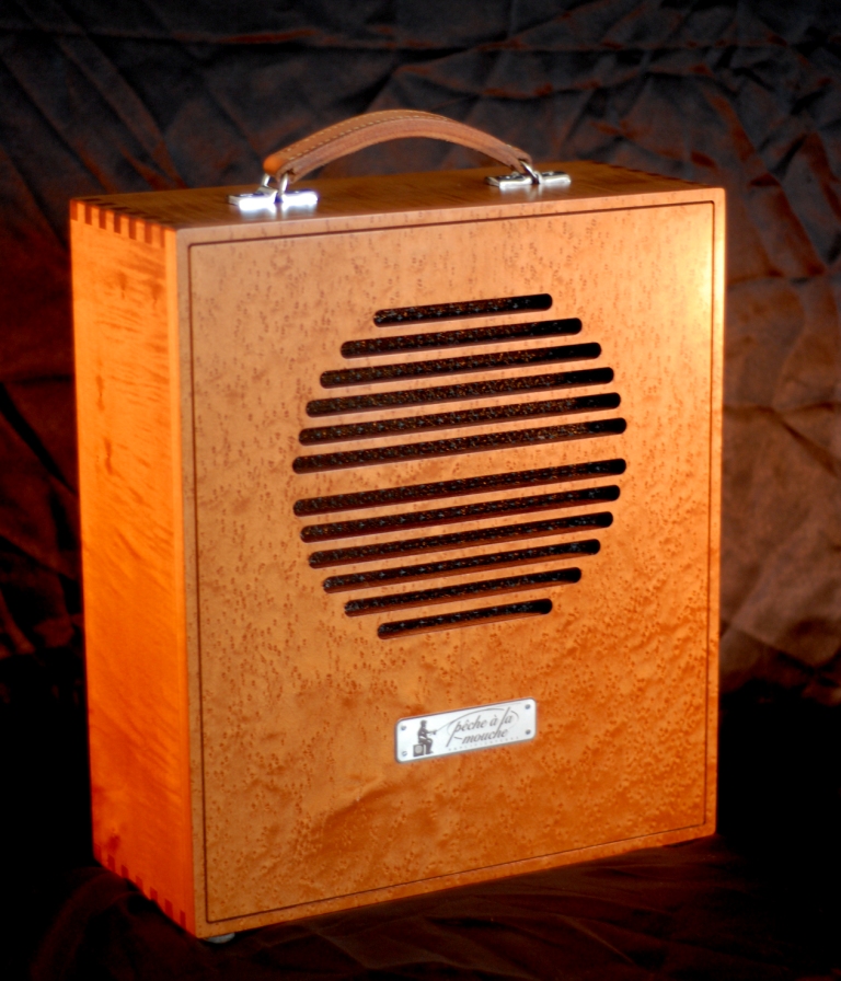

The "Deluxe" model is built of plain-flame maple or basswood (tulipwood), while the front is made of multi-layer wood. This is covered with precious wood, such as bird's-eye maple, plane tree or walnut.

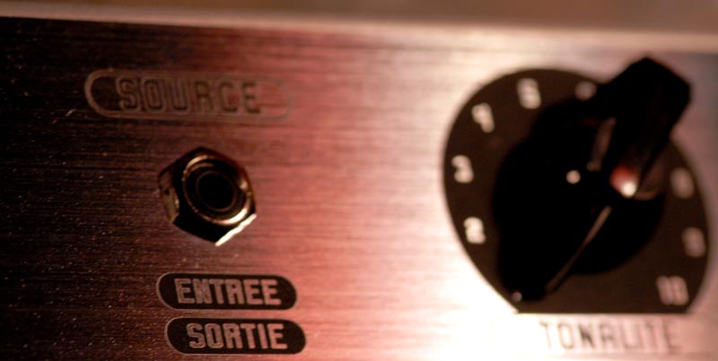

  • Input and outupt (jacks 3.5/mono)

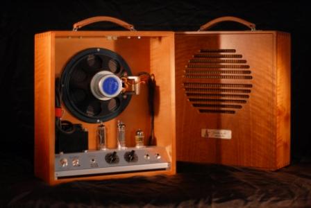

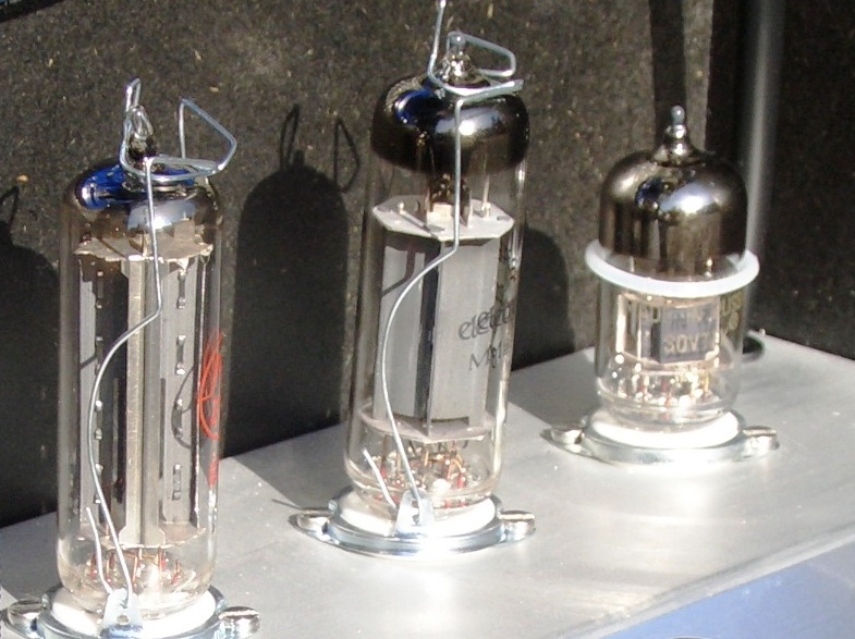

The tubes on our amps are chosen and tested for their musical qualities. You can notice on this picture from left to right :
-A voltage rectifier 6CA4 or EZ81 tube.
-A EL84 power tube.
-A pre-amplification 12AX7 or ECC83 double triode tube that can be replaced by a 12AT7 or ECC81 that has a 30% lower gain and allows therefore to delay the amplifiers saturation.

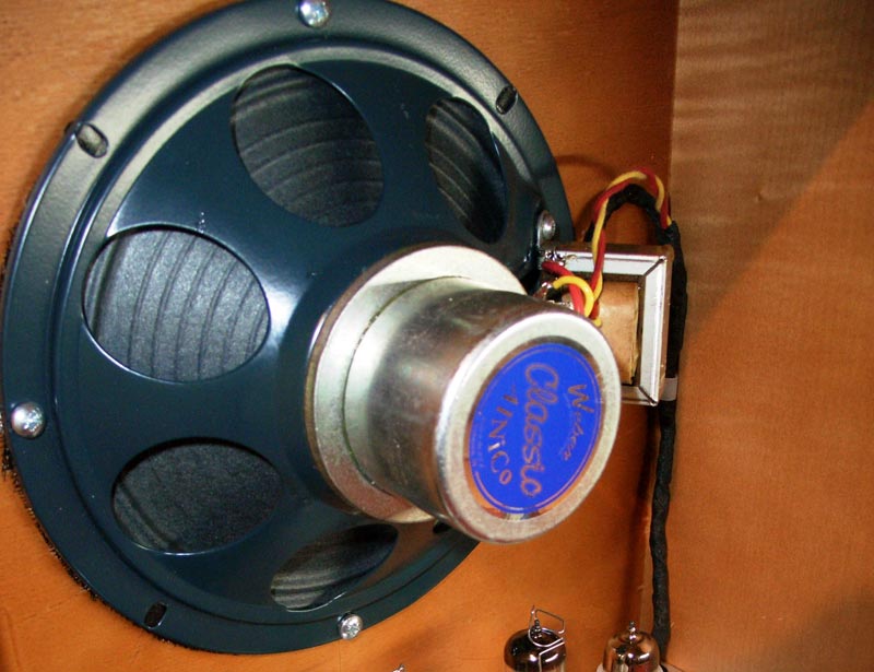

A speaker built according to our specifications, provided with an ALNICO magnet, ideal for a warm sound.
The output transformer is "old fashioned"wound.
