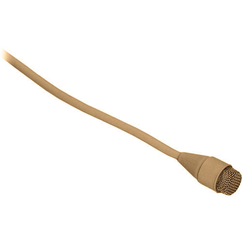

The Type 4061-CM is the brown version of the Miniature Microphone Type 4061. This type is a prepolarized omnidirectional Miniature Condenser Microphone with a 5,4mm vertical diaphragm specially designed maximum performance under the often difficult conditions when mounted directly on the human body.
Special attention has been paid in the design, to the humidity problems that often occur in theatrical applications. A double vent protection system together with water resistant materials inside the microphone, makes it more than difficult for the humidity to cause the Miniature Microphone to fail. By changing the protection grids, the Miniature Microphones can furthermore be acoustically modified according to the placement of the microphone on the human body.
Type 4061 is acoustically identical with the award winning Type 4060, but the sensitivity is adjusted to 6mV/Pa to match some of the more sensitive transmitters on the market.
A wide range of connection adapters makes it possible to use the 4061 with most of the professional wireless systems available plus 48 V phantom.
Tech Specs
Microphone Type Condenser
Polar Pattern Omni
Frequency Response 20Hz-20kHz
Max SPL 144dB SPL
Output Impedance 30-40 ohms
Signal to Noise Ratio 68dB (A weighted)
Self Noise 26dB (A weighted)
Color Brown
Cable Length 5.8 ft.
Connector MicroDot
Weight .02 lb. (7.5g)
