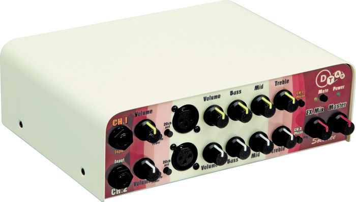

D-TAR Solstice Blender Preamp
A high-quality 2-channel preamp mixer suitable for both live and studio use.
The D-TAR Solstice is a high quality 2-channel preamp mixer that blends virtually any type of sound source. The low-noise hybrid circuitry and internally adjustable gain from 0 to 24db make the Solstice blender preamp suitable for both live and studio use. Solstice is a perfect preamp for musicians looking to live-mix up to 4 sources such as piezo pickups, magnetic pickups, standard mics, and high output condenser mics.

Features
¼" and XLR inputs on each channel allows either a microphone or pickup input on either channel
Balanced XLR mic input with true gain control for optimum headroom and lowest noise
Utilizes discrete hybrid circuitry as in high end mixing consoles
Full 3 way level / clip indicator helps set optimum gain for best headroom and signal to noise ratio
Phase reverse switch helps control acoustic feedback
Channel effects loop with send and return jacks can be used as independent signal output or as insertion point for external signal
Mute switch allows complete shut off of rig
Tuner output (unaffected by mute switch) allows quiet tuning
Stereo input jack allows access to both channels with one stereo cable

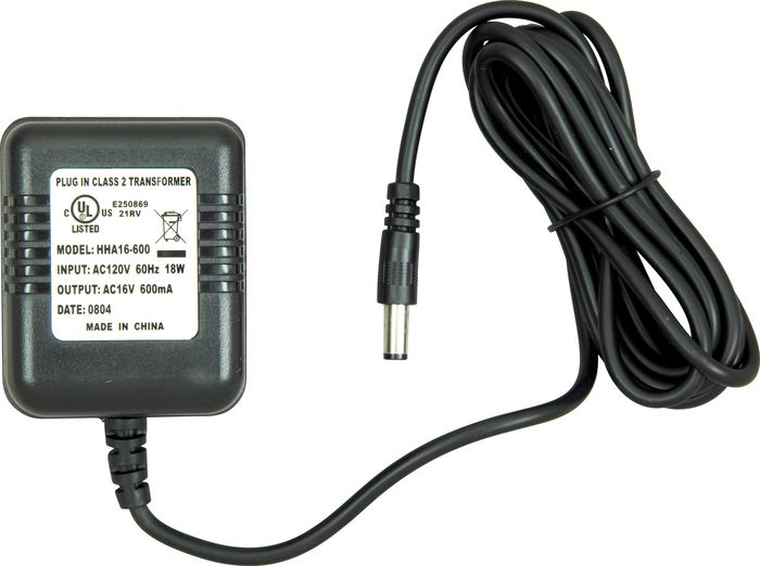

External wall mount power supply allows AC operation
High quality components provide extremely low noise and distortion, audiophile quality sound
Mic stand adapter available as an option
Solstice Blender Preamp Specifications:
Input
Two Channel Preamp
+15 volt phantom power
Two Ultra-High impedance 10 Meg Ohm stereo ¼" input jacks
Two XLR input jacks with 40dB of gain and switchable 20dB pad
OutputMain XLR output
Two post EQ balanced XLR outputs
Single-ended buffered output with very low output impedance
Master Effects signal output (line level)
Two ¼" stereo insertion points
Tuner / auxiliary output
Dimensions: 8.5" wide x 6.5" deep x 2.7" high
Weight: 2.9lb.
Gain: Single Ended Input: 30dB (adjustable); Mic Input: 50dB (20dB pad available)
Noise (Referred to input): Single Ended Input: >110dBV; Mic Input: >125dBV
THD (@ 2Vo, tone controls flat): Single Ended Input: < .01%; Mic Input: < .01%
Frequency response (±3dB): Single Ended Input: 20Hz — 80 KHz; Mic Input: 20Hz — 80 KHz
Maximum Input Level: Single Ended Input: 1 Vrms; Mic Input: 75mV 700Mv w/20dB pad
Maximum Output Level: Single Ended Input: 7.2 Vrms; Mic Input: 7.2 Vrms; Input Impedance: Single Ended Input: 10 MegΩ; Mic Input: 8 KΩ (differential)
Slew Rate: Single Ended Input: 13 V/uS; Mic Input: 13 V/uS
EQ Frequencies
Bass: 155Hz / .61Q
Midrange: 796Hz / .56Q
Treble: 10KHz / .37Q
