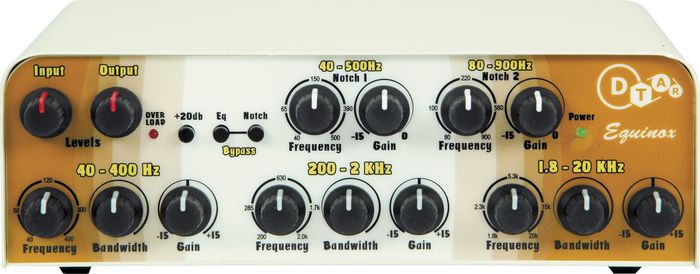

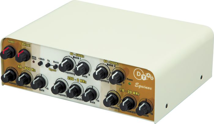

3 Band Parametric Equalizer Preamp — Allows precise EQ control to correct or enhance very specific tonal problem areas with frequency sweep control, bandwidth control, and boost/cut control
Two independent notch filters Eliminate acoustic feedback
20 dB gain switch Provides instant gain

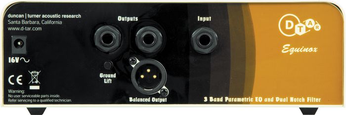

Input Jack: ¼" Stereo, input on tip / output on ring, allows interface with DTAR Solstice (Acoustic Mixer) using a single, stereo cable.
Output Jack: 1/4" Mono

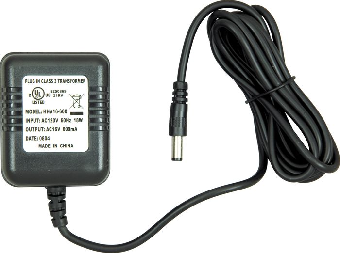

Power Supply: Internal ±15V derived from 15VAC external, wall mounted power transformer.

3-Band EQ: each band has adjustable Q (bandwidth) from .58 to 9.4 with 15 dB of boost and cut available
Low Frequency Band: Frequency adjustable from 39 Hz to 408 Hz
Midrange Frequency Band: Frequency adjustable from 212 Hz to 2.35 KHz
High Frequency Band: Frequency adjustable from 1.8 KHz to 20 KHz
Notch Filters: Q (bandwidth) fixed at 9.0 with 15 dB of cut available
Notch Filter #1: Frequency adjustable from 40 Hz-400
Notch Filter #2: Frequency adjustable from 80 Hz-800
