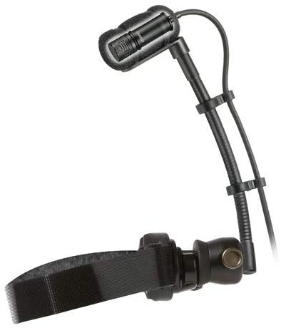

Designed for use with woodwinds, the ATM350W UniMount® mounting system gives you the tools to perform with confidence. The system features the ATM350a cardioid condenser microphone, a high-SPL mic that provides a clear, well-balanced response from any instrument.
When teamed with the included AT8491W woodwind mount and strong, flexible AT8490 5" gooseneck, the mic can be securely fastened to any woodwind instrument and positioned to stay where you want it – the gooseneck won’t flop around no matter how much you move the instrument as you play. The microphone’s cardioid polar pattern isolates the instrument by reducing side and rear pickup, and the switchable 80 Hz high-pass filter on the in-line power module helps control undesired low-frequency noise. The system also includes an AT8468 violin mount with hook-and-loop fastener and a protective carrying case.

Element:                    Fixed-charge back plate, permanently polarized condenser
Polar Pattern:                Cardioid
Frequency Response:            40 – 20,000 Hz
Low Frequency Roll Off:            80 Hz, 12 dB/octave
Open Circuit Sensitivity:        –49 dB (3.5 mV) re 1V at 1 Pa
Maximum Input Sound Level:        159 dB SPL, 1 kHz at 1% T.H.D.
Dynamic Range:                130 dB, 1 kHz at Max SPL
Signal-to-Noise Ratio:            65 dB, 1 kHz at 1 Pa
Phantom Power Requirements:        11– 52V DC, 3.5 mA typical
Switches:                    Flat, roll-off
Weight (Microphone):            14.5 g (0.5 oz)
Weight (Power Module):            90 g (3.2 oz)
Cable:                    4.0 m (13.1') long (permanently attached to microphone), 3.2 mm (0.13") diameter, 2-conductor shielded cable with HIROSE HR10-type connector
Dimensions (Microphone):        37.8 mm (1.49'') long, 12.2 mm (0.48'') maximum body diameter
Dimensions (Power Module):        92 mm (3.62") long, 18.9 mm (0.74") diameter
Output Connector (Power Module):    Integral 3-pin XLRM-type
Optional Interchangeable Elements:    UE-H hypercardioid (100°); UE-O omnidirectional (360°)
Accessories Included:            ATM350a cardioid condenser microphone; AT8543 power module; AT8491W UniMount® woodwind mount; AT8490 UniMount® 5" gooseneck; AT8468 violin mount (hook-and-loop fastener); protective carrying case
