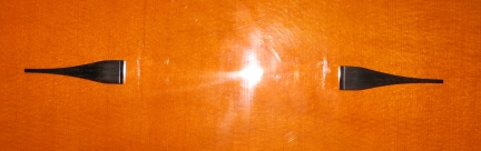

As received, a couple of items were of immediate note. The tail-piece had some minor corrosion and looked "cheap." A quick pass under the buffer took care of the stains and made it look quite respectable. The mustache bridge ends, while obviously ebony, had square edges that also struck me as what one might expect on an inexpensive knock-off. Rounding the edges a bit before gluing would improve their appearance. Also, the mustache ends were unevenly clamped, resulting in sharp indentations in the spruce top at their tips. I took a look under a magnifier and determined that the top had not cracked at these places. The movable portion of the bridge would have benefited greatly from being contoured to the top. Under string tension for nearly two years the outer edges of the feet had deformed the top, again almost cracking it. I immediately sandpaper-shaped the bridge to the top, hoping to avert disaster as the guitar acclimated to our 50-55% relative humidity. Also, the string notches were sloppy and not of the correct depth. They appeared as if made with a pocket knife.

    In keeping with the "picture is worth a thousand words" principle, here are a couple photos that show the sharp edges of the mustache ends as well as the damage to the top from over-clamping and an ill-fitted bridge centerpiece. I apologize for the blurry close-up, but it highlights the top deformation quite nicely:

    You're probably all over this already - but keep an eye on that bridge. If it did deform the top, then you fit it to a deformed top and either the bridge and top will or won't find a happy medium as they ajust over the years. Mostly they do - but this one looked really tweaked - and sometimes - if the top was deformed enough it will start going back to its original shape now that you've relieved some of the pressure - and you may start seeing it pinch again as it does that - though to a lesser degree. Don't stress (pun intended) about it too hard though. All GJ guitar bridges appear to pinch a little if you hold them in the right light and they're sufficiently glossy to see details. This happens because bridge feet are very rigid and tops actually change a tiny bit in height (and therefore in radius) as humidity changes - and also because the bridge does 'load' the top to some degree. You can very very very gently ease the inner and outer edges of the bridge feet to reduce this somewhat.

    Thanks for your insightful comments -especially the advice to periodically check these spots and re- re-shape the bridge! Having played mandolin for over 35 years, I'm very familiar with what a non-fixed, hard ebony bridge does to a soft spruce top... over time. This Manouche, though, came out of the paddock with serious stress.
    I breathed easier when I took a good close look and saw that neither the finish nor the underlying wood were cracked. After only a few days I can "note" improvement (I'll see your pun and raise it!) in the top near the bridge. I am guessing that this guitar is still acclimating to the local humidity after more than a year in dry, dry, dry New Mexico. Robert Brochey told me sometimes their relative humidity gets as low as 8%. I can almost hear the splintering of Selmac tops at the very thought of single-digit RH.
