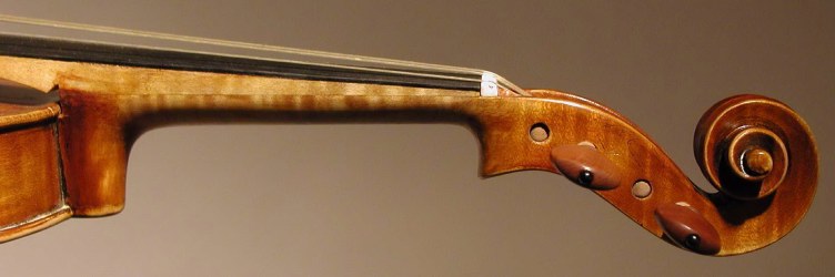

    cbwim, I love your approach and have dreamed of something similar. I have had thoughts (dreams) about adding a wedge under the fingerboard of a flattop, but it didn't occur to me that wood might be removed from the neck to create the angle. Great call. Baroque violins had similar wedged necks.

    You can see the former fingerboard, which surprisingly was made from a hard maple plywood. It planed down beautifully into the wedge. For sure - the wedges used under the fingerboards on Baroque violins were the inspiration for this approach. I've spent plenty of time hanging around with violin makers over the years.
